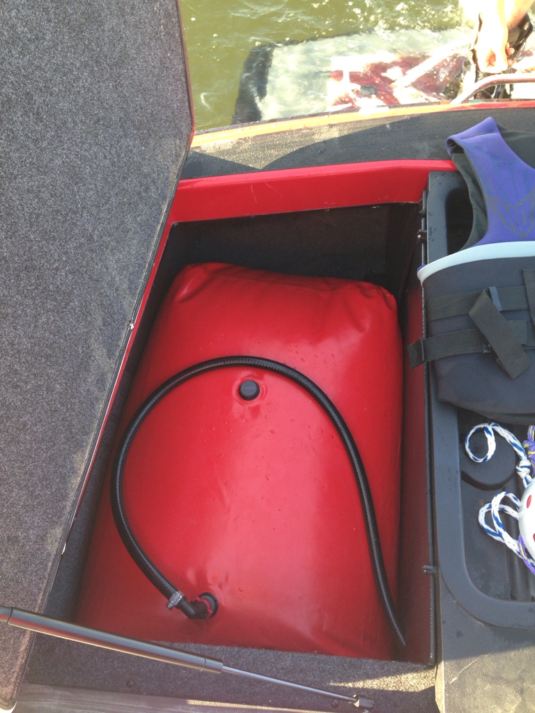

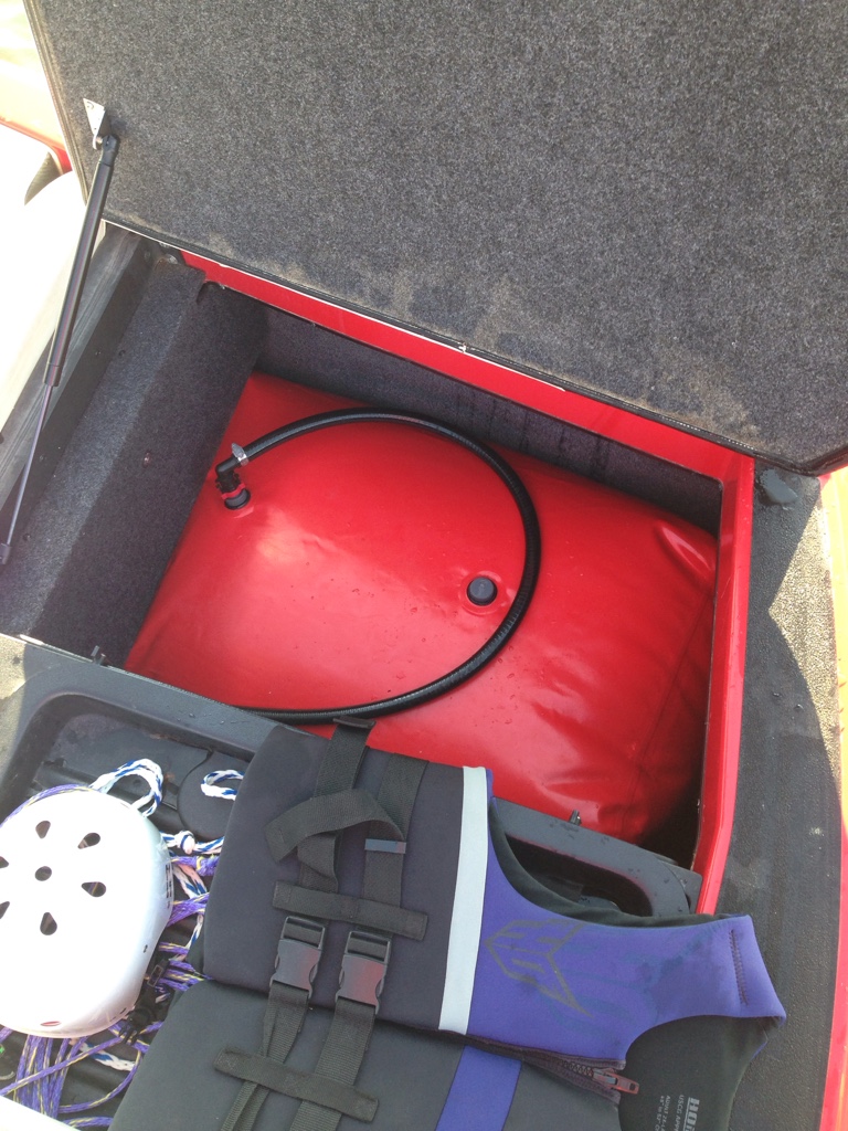

 Post subject: Re: pull hard tanks and go bigger?
PostPosted: Fri Aug 07, 2015 4:28 pm
Mine are somewhere in the 700-750 range, fits great and fills completely
PostPosted: Fri Aug 07, 2015 7:38 pm
What year is Johnny's boat? My 750s look like they take up less room on top of the hard tanks then Walters without the tank. I think Walter's is 10 or 11.
