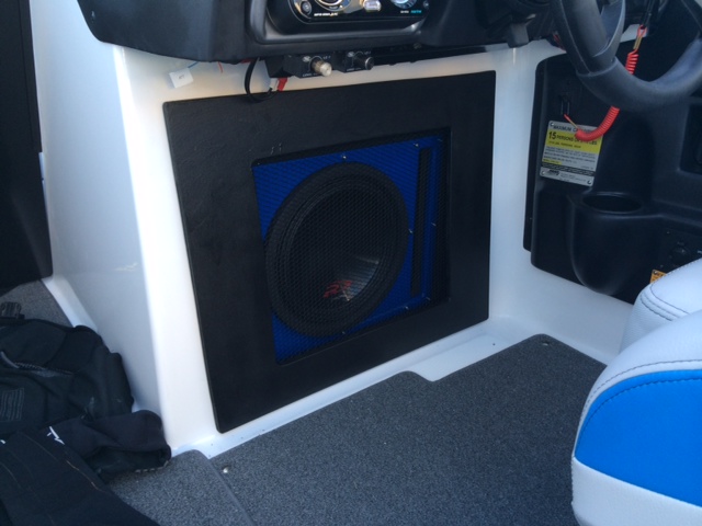

1/2" birch plywood with a sealing primer and bed liner sprayed on. The grate is expanded metal that I coated with bed liner. The tricky part was getting the right bottom corner to sit flush. Originally I bolted the face on but ended up going to Velcro. I also added subwoofer cloth to hide the cavity and sub.

finally finished mine... looks great and doesn't vibrate!
1/2"mdf
sealed with resin
sprayed bedliner
secured with velcro
Thanks for all of the tips.

lol... in this pic you can see the speaker more than you can in person.
this set up sounds great. I paired the type r with an alpine 1100 w amp
