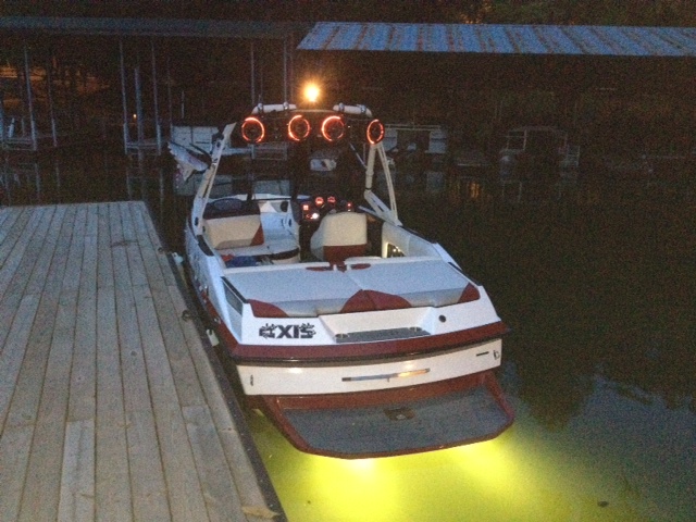

Here is a picture tied up later on... Because everyone loves lights and i'm just too excited that the weather is warming up.
