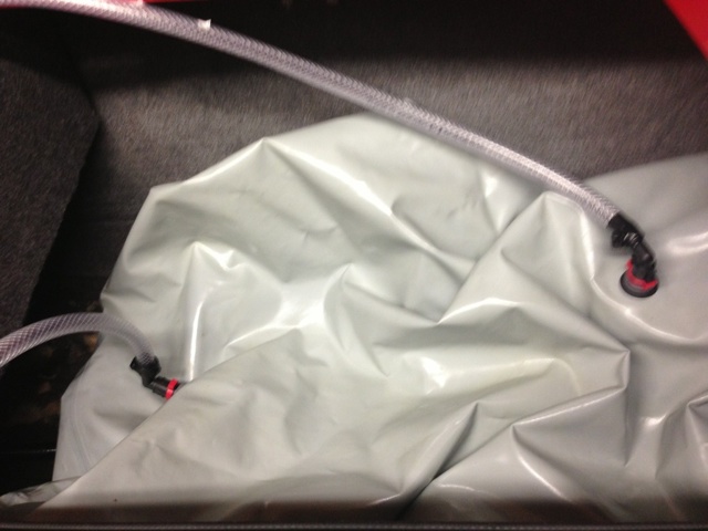

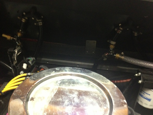

Installed PNP in a friends 2010 A22 and used dual fill method.
