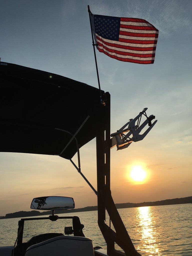

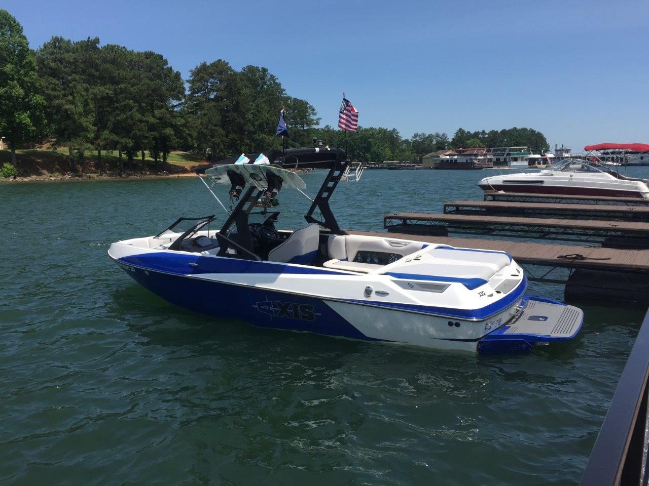

The US flag is 18" x 24" on a 4' pole. The other flag is on a 2' pole and 12" x 18".
I can run at speed with them up. I think they are about the perfect dimensions.
Used all Firestik pieces. Stainless flag holder bolted through the flat arm of the tower. Since the tower is angled I had to fool around with varied SS hardware to get the right pieces and offset the angle to make the flagpole more plumb. The poles screw into the holder. The only think I have to watch is that they will back out so I do a quick single wrap of electrical tape around the base and that seems to keep them from backing off.
