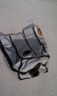

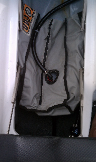

Did it. I will test it wednesday to make sure it allows sack to fill all the way with the cover zipped up, if not I will leave it unzipped. here are some shots of it installed and outside.
The dimensions are aprox 12" x 12" x however long I cut it... 20" ?
I gave one to Ed, and have 2 more. If you want one, I will sell it to you for the price of shipping and packaging... first 2 guys to PM me get them.
