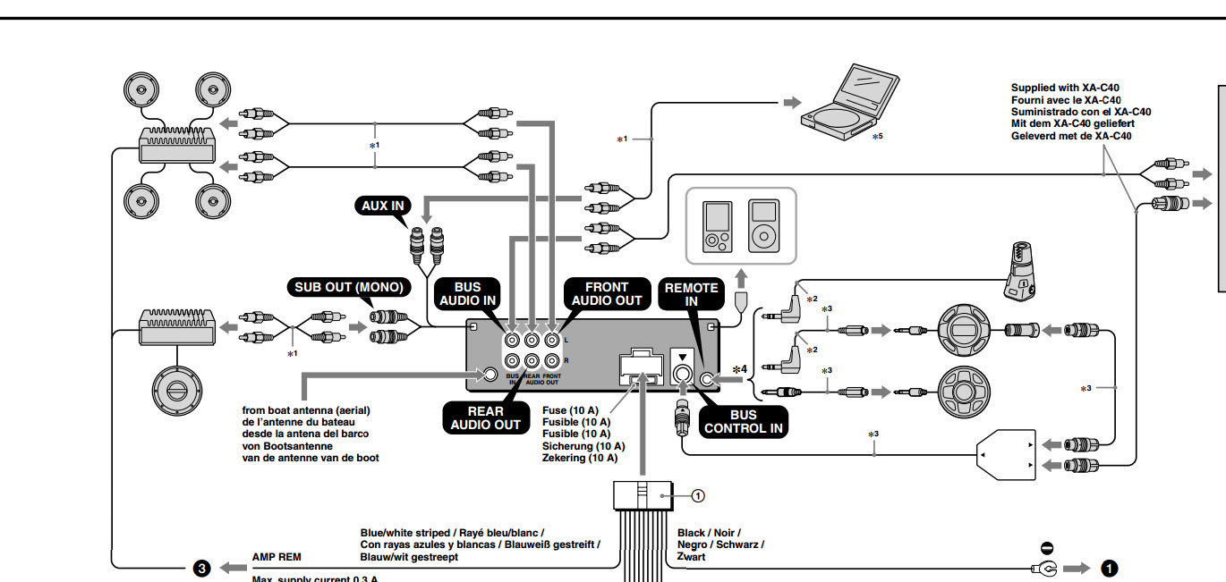

Need pics of where this connection is! My auto volume has never worked. It turned on in the instrument cluster but does nothing.
Maybe mine is just not connected.
Thanks in advance
 Post subject: Re: Stereo Issue
PostPosted: Wed Sep 24, 2014 12:22 pm
Joined: Mon Jul 28, 2014 9:59 am
Posts: 8
Location: san antonio, tx
Here is the image from the manual. What plug are we talking about?
PostPosted: Thu Sep 25, 2014 11:41 am
Posts: 178
Location: Parker Strip, AZ
REMOTE IN. If you notice this is shown connecting to either the twisty remote above or the dashboard remotes.
The problem is that the back panel has a bump adjacent to the connection that can hit the molded plastic plug body and prevent it from engaging fully. So instead of getting its signal as volume change, it thinks it is getting told to change channels.
It is easy to see. Lay on your back with head under dash board. As you will note above, it is the right-most connector when looking from the back. I used a knife and shaved the plastic down and it works perfectly and I love the feature.
