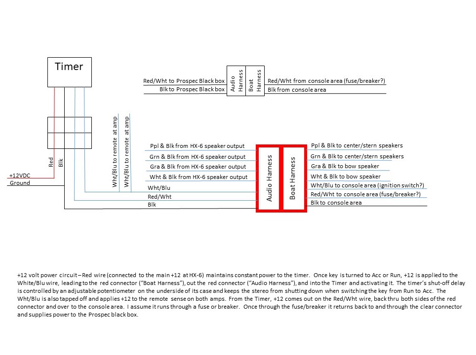

Factory SP2 seems to have the following setup.
HX-6:
- channel 1/2 - center and stern speakers connected in parallel (right left split) at 2 ohms.
- channel 3/4 - bow speakers at 4 ohms
- channel 5/6 - bridged to the sub at 4 ohms
HX-2:
- channel 1/2 - 4 tower speakers connected in parallel (right/left split) at 2 ohms 2 Amps.
While the amps are rated to run 2 ohms per channel, I'm not a big fan of parallelling speakers or mismatched channels on the same amp.

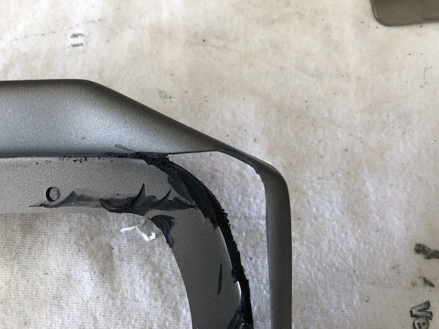

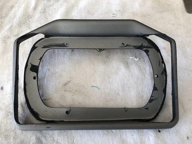

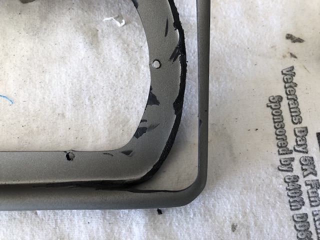

For the control head, I was able to carefully slowly cut the silver dash trim ring enough to maintain integrity in the plastic AND allow the controller to be mounted in it. I also had to use a scrap piece of aluminum to make the mounting bracket work.

I kept the timer circuit in play (nice option since the MC-1 takes a few seconds to boot up). The timer is located on the back side of the panel that the amps are bolted to. Since the MC-1 maintains all of its settings when all power is lost, i chose to tie the constant hot and ignition wire on the MC-1 to the timed 12 volts line. This way, when i kill the main power switch, the radio cant continue to pull power. The black box remote lines were used for the amps.
I made a schematic of what the factory stereo wiring looks like.

Small update. With both the ignition and battery wire tied to the timer circuit, when the timer timed out, the entire stereo would do a "hard" shutdown. This resulted in a loud, high pitched squeal and pop form all speakers. Thinking that the radio needs to do a "softer" shutdown i decided to run the battery wire to a main (switchable) battery connection. Radio works perfect now! Now, when you turn the ignition off and the timer runs its course, the MC-1 actually runs its normal shutdown sequence. No pops, no squeals.
