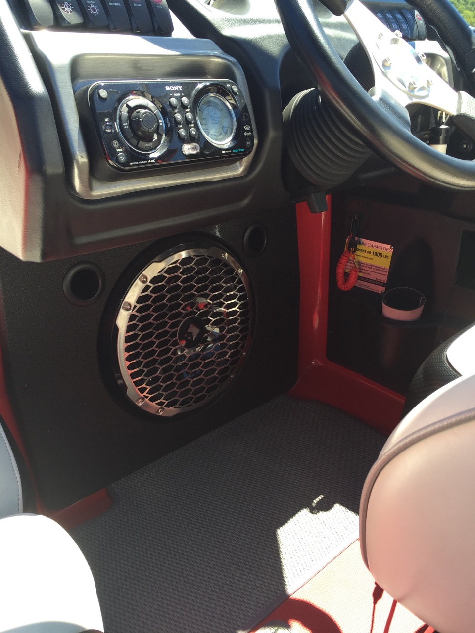

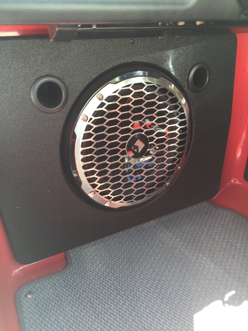

Here are some pics of the subwoofer box I built to fit under the helm. I originally designed as a sealed box with approximately 1.0 cu ft of volume. I was very unhappy with the performance and after speaking with a friend that installs lots of marine stereo equipment, he convinced me to try a 1.5 cu ft ported design. I am glad I listened to him and made the changes as it was a night and day difference. I am very happy with the finished product.

Thanks for sharing. Im about to do the same project. Any dimensions and pics of the box? Do you have a heater in there to deal with? Cant believe its been 20+ years since I built a sub box and thinking about doing it again...

I traced the original footwell panel to make the front panel. I'll have to look and see if I kept any of the information on the size of the box. To get the 1.5 cu ft box to fit I did change out the steering cable to a longer cable. I did not have a heater to deal with. I highly recommend the upgrade to move the subwoofer out of the storage compartment.
