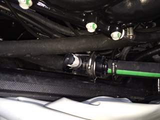

I forgot to post a picture of the Perko Flush valve and installation. I hope to test out the hose connection and winterization in a few weeks. I want to get 1-2 more days on the water first.
