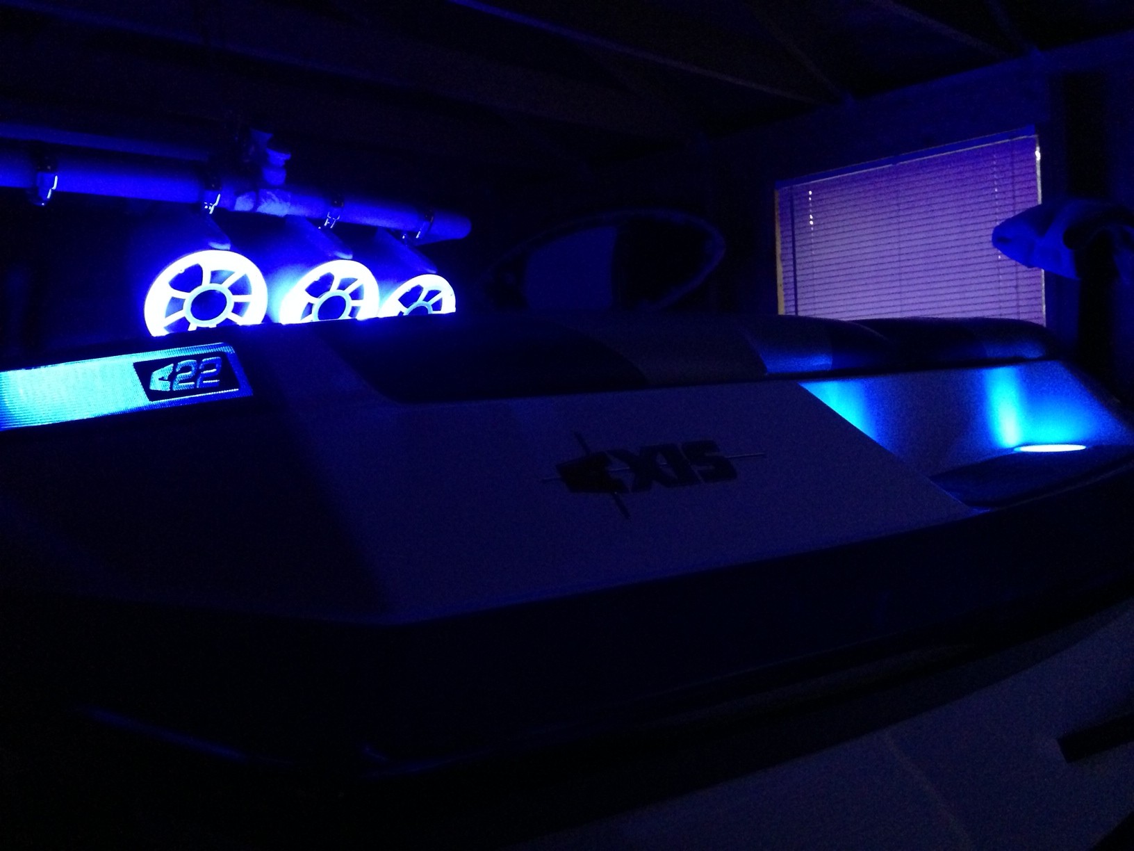

Just finished up my last project for the year... now I can see where to put AJ's passion fruity drinks at night and not fall off the step...
Cost me about $26 in material to do this.

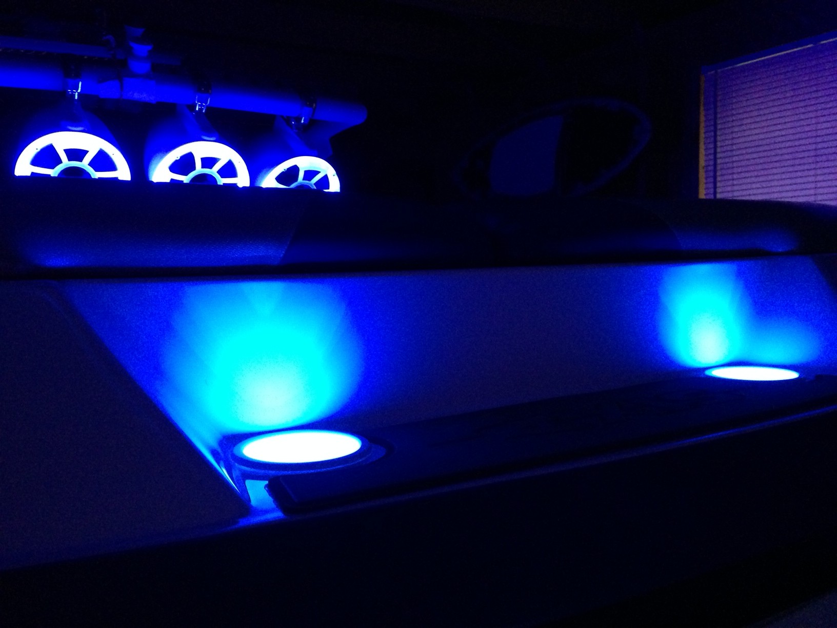

Academy Outdoors has white cup holders that fit... i think they a 3.5 inch diameter... 2.95/ea.
Advanced Auto has the single LED lights in a 4 pack for $10.00.
Ran a hot wire from the dual-direction toggle switch around the aft of the boat to pick up my grill lights and these cup holders.
Placed 4 lights in each cup by drilling holes just big enough for each light and some e6000 glue... a little sodder, quick connects from Radio Shack, and zip ties and BOOM.
Have 1 of the REV10s off the swivel clamp for storage... those things are beastly heavy...
