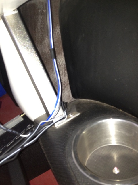

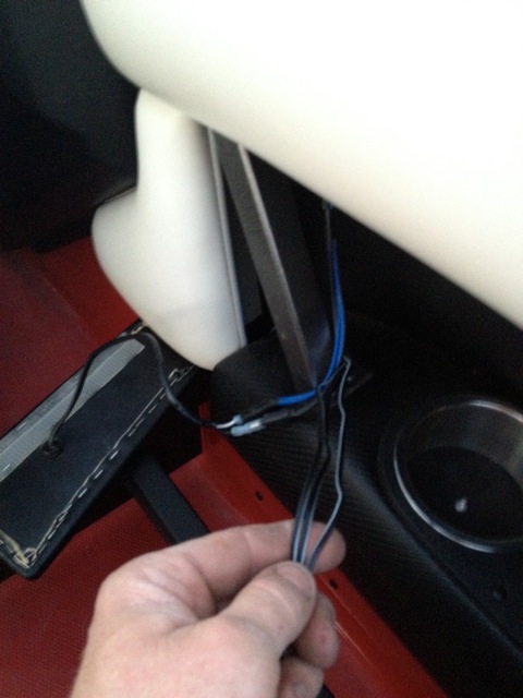

Did you splice into existing wiring for interior leds?
 Post subject: Re: DIY LEDs in your boat.
PostPosted: Sat Jan 21, 2012 9:10 pm
yup, for the cup holders I tied the wires to the little white light above them on the removable panel, the ones under the seat cushion I tied to the forward LED that was already under the seat, just pulled out the existing light and put the wire through the hole and pushed the light back in, the wires were like 18 gauge so they were thin enough to fit with ease, that and I didn't want to drill a hole in this thing for two tiny wires
