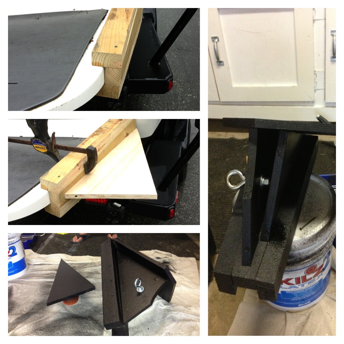

Here goes nothing...

Those lines look great, but Im a little worried about the force on the lower part of the paddle. Seems like a lot of downward force on those screws. When the screws are across the middle of the paddle, the force of the water cancels out.

Reinforced, painted, and Ready for testing!

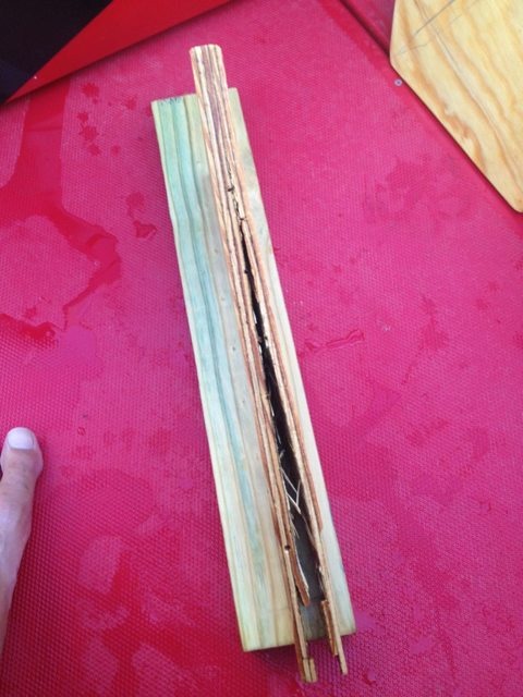

@VA. I had to reinforce the middle piece. This is what happened the first try out.

The screws just split the plywood
