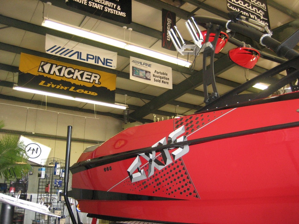

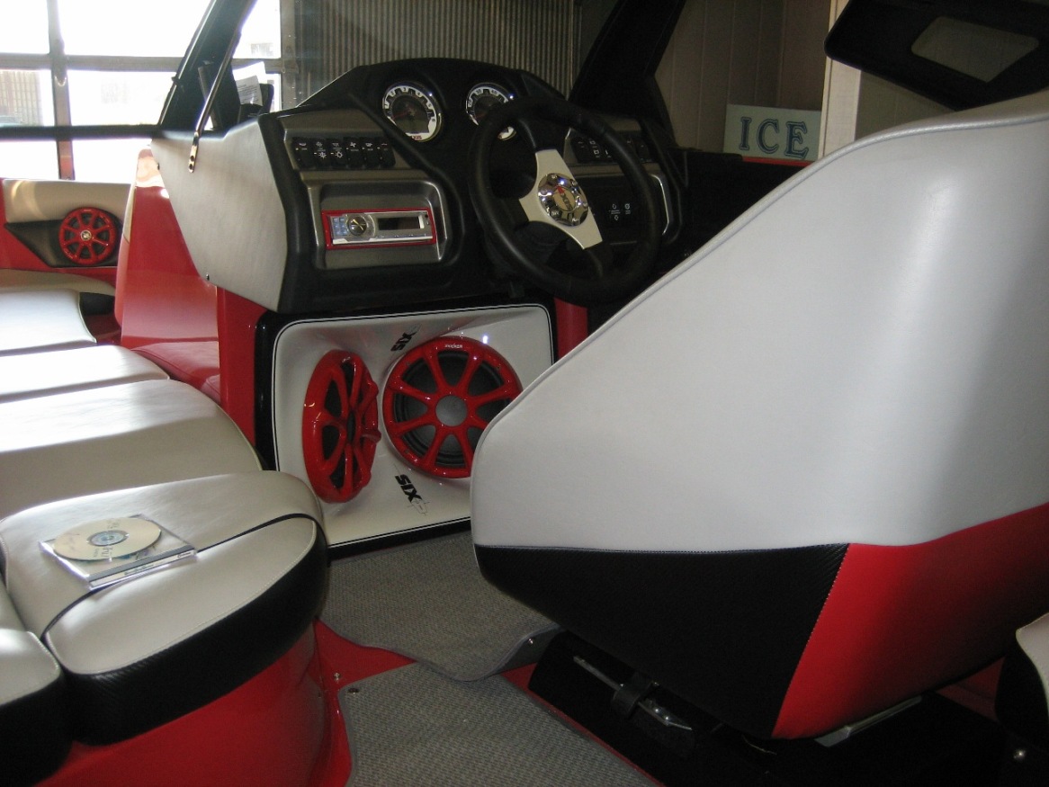

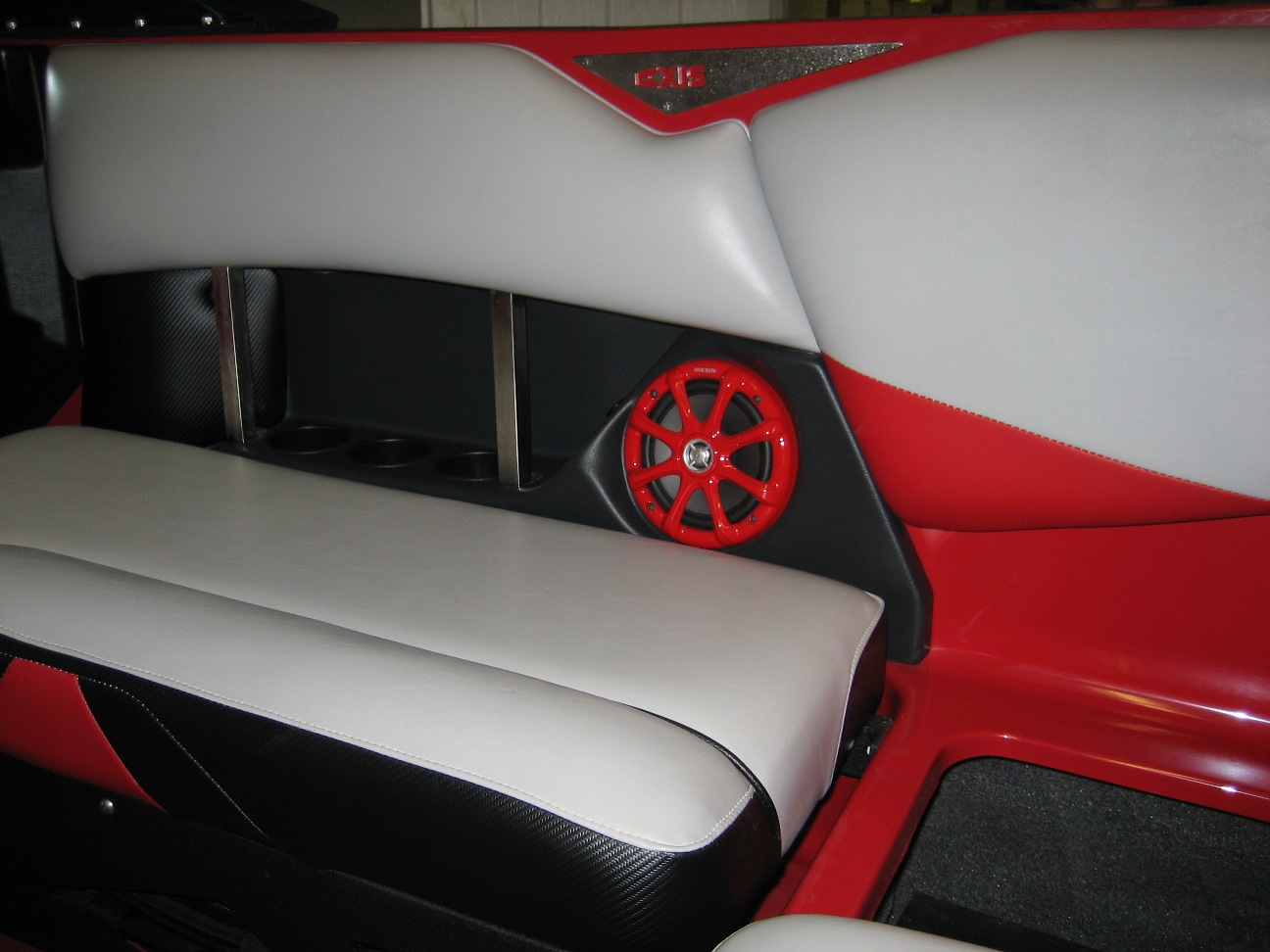

They are almost finished. A big thank you to 4N Motorsports (facebook.com/pages/4N-MOTORSPORTS/147927108251)!!!!
Poplar Bluff, Missouri

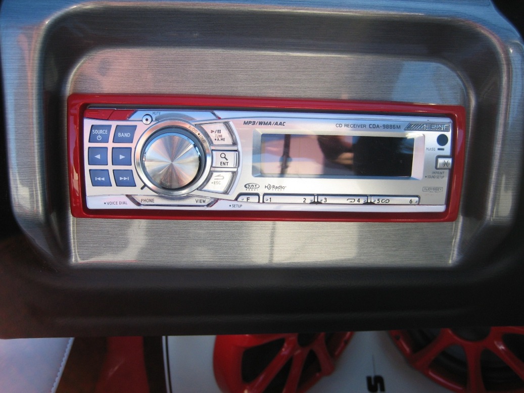

More pics,,,,

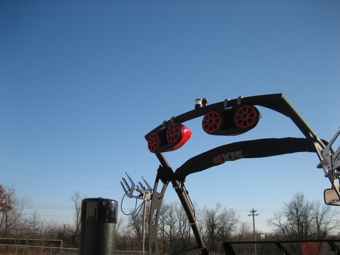

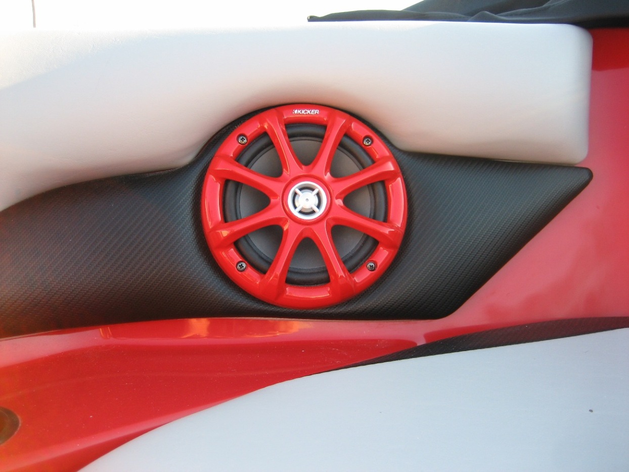

and last 3,,,sorry how big the pics are

Wow!!! Nice job
 Post subject: Re: 2011 A22 - Stereo Install - Clamp Question
PostPosted: Fri Jan 06, 2012 6:41 pm
Posts: 165
I have so many car systems floating around and a few boats; however, this install in amazing. This is making me scratch my head to do more work. It looks very nice.
Gibby
2011 A22 Vandall
PostPosted: Sat Jan 07, 2012 7:35 am
Very nice install. Looks good. Really nice job on the sub under the dash!!!!!!
PostPosted: Sun Jan 08, 2012 12:09 pm
Joined: Wed Dec 14, 2011 10:33 am
Posts: 17
Thank You!! Joey at 4N Motorsports is amazing at custom work... He was very excited about putting something together for the Axis. If anyone needs any custom work done, I highly recommend him.... Now where to go from here :-)

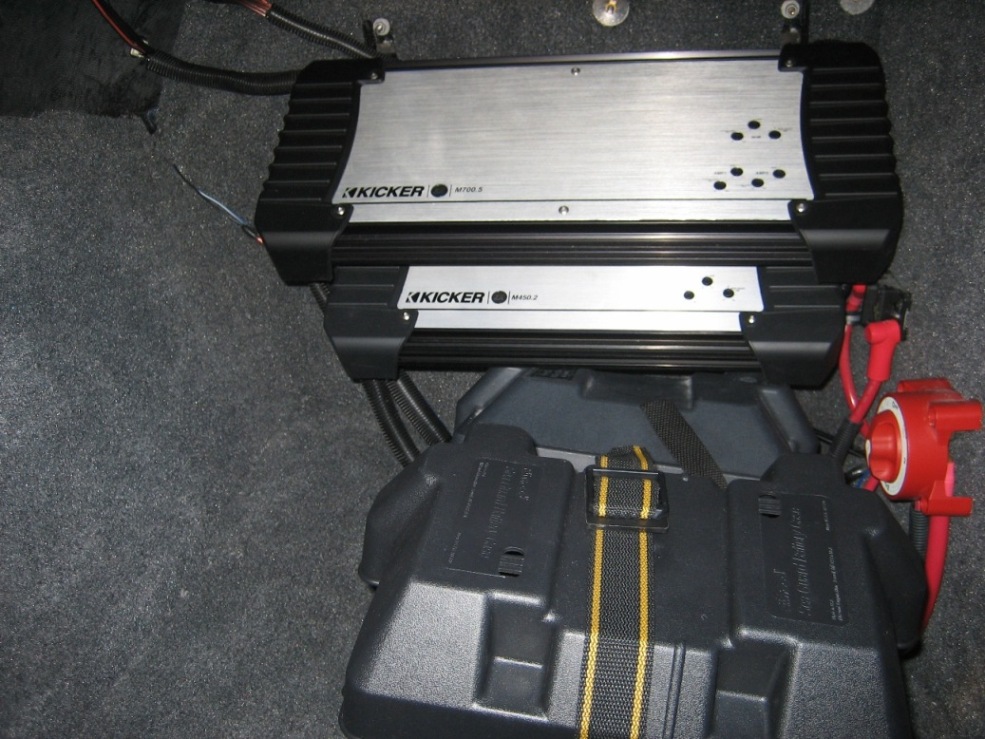

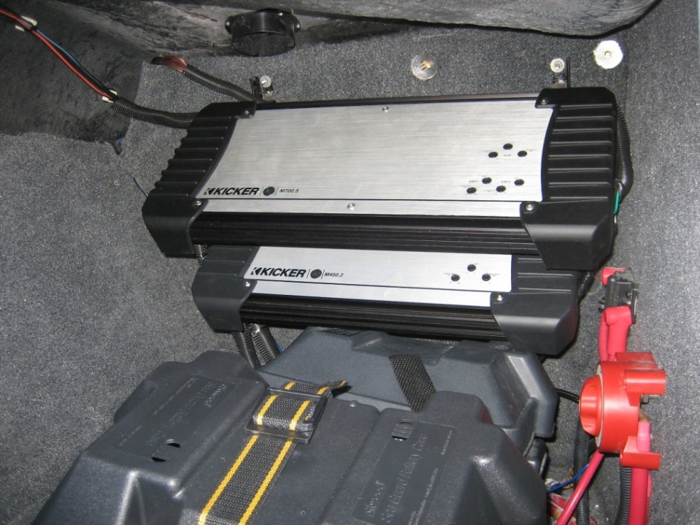

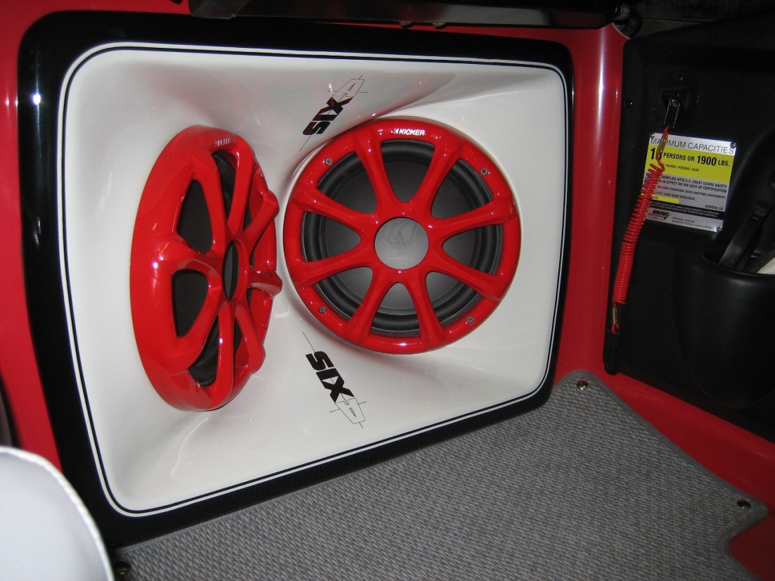

Looks good! I'm curious how those subs will sound. 10's wired in parallel off the 700.5?
PostPosted: Tue Jan 17, 2012 8:57 pm
Posts: 165
Kicker KM10's have 4ohm coils. 2 in parallel will drop the load to 2 ohms which I am sure you know. That 700.5 is a nasty amp for a 5 channel. I have run a solobaric on one. Its 2 ohm stable. I have been dealing with kicker for years now. The only time I see there subs blow is due to people not letting them cool down and they sieze up.
Gibby
2011 A22 Vandall
PostPosted: Wed Jan 18, 2012 9:34 am
Posts: 17
I'm sure that I am totally biased, but the boat sounds unbelievable. The two KM10's perform amazing. If you or anyone is in Southern Missouri or Northern Arkansas, please get in contact with me to hear the system. I am very very pleased.
