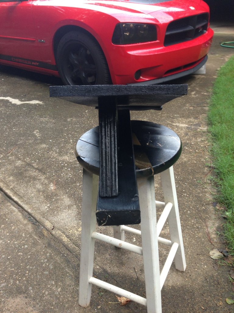

Joey, can you share the other dimensions? Particularly the front and back widths - I'm going to build one later and my math skills are a little impaired. Cheers!
Haha. U got it man. It was really simple.
Surface area:
Top length just over 21":
Bottom length just over 22" (w the notch/contour in between):
Height just over 10":

2x4 length, (Probably doesn't really matter much) 20.5":
Angle between 2x4 and paddle, 22 degrees:

Let me know how ur build goes and if u come up with any improvements along the way. I like Walters idea of somehow connecting it to the tie down loop and swim deck bracket.

Oh and the other thing I'll probably change is where I attached the "tab" to the "mount". I attached it on the lower side of the tab not knowing how deep it'd need to sit in the water. I plan to raise the attachment point up a bit to sit more directly in the middle of the backside of the tab. Where it attaches now there are a few inches that sit above the water.

How does it steer when turning around to pick up a rider? Also do you have the newer surf platform? If so wouldn't your angle off the rear be less than 22 degrees because the platform angles in a little bit?

I have the older platform so it mirrors the angle of the hull.
