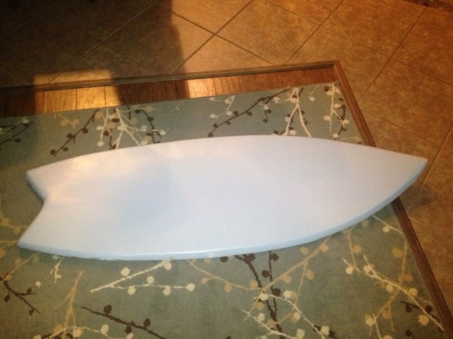

You inspired me to take a shot at making one. We finished in less the a week working on it in the evenings. This is it before we put final paint job on it.

Awesome job man... did u use epoxy or is that before fiberglass? Im glad you were inspired... i just wish it was summer :(

I did it a little out of order. I did two layers of glass on both sides first. Then a ton of sanding to try and smooth out. The color you see is just a basic car primer that my buddy through on at his body shop. We are going to test it this weekend. (Its going to be 70 this weekend in south texas.) If it works, he is going to put a bad ass candy paint job on it. I will keep you posted to let you know how the car paint holds up.
