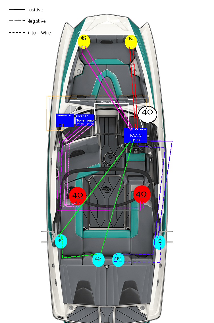

We are redoing the aftermarket stereo system on our 2012 a22. I developed this basic (honestly even a little crude) wiring diagram for our installation. Any thoughts? Thought this may even help anyone else looking at working on their a22. PDF file is attached below.

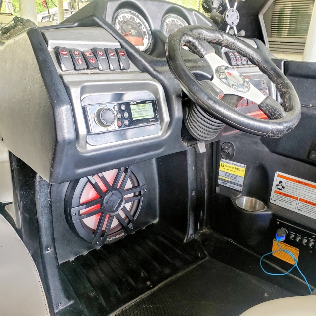

Nice diagram. You only have two tower speakers? My 2010 A22 has similar speaker layouts, but 4 tower speakers (2 channel @ 2ohm) and all the speaker wires run to the passenger side closet. Two 4 channel MTX amps in there and the original 12" sub. I have since moved my factory sub from the closet (dumbest design) to the drivers footwell.
