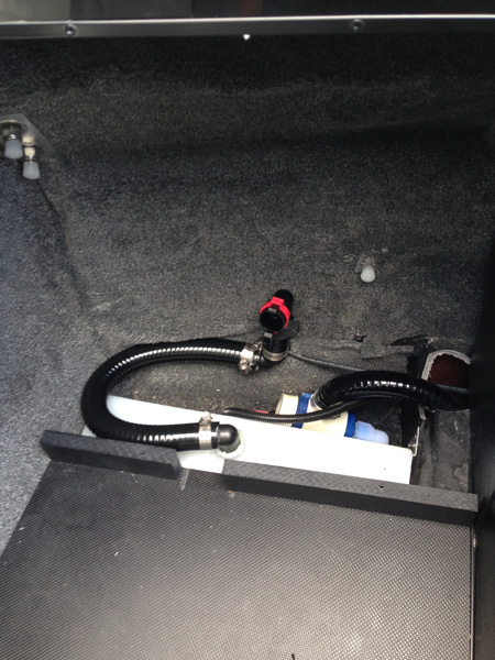

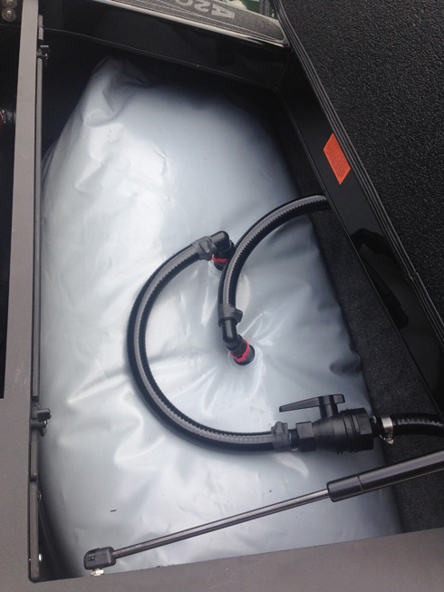

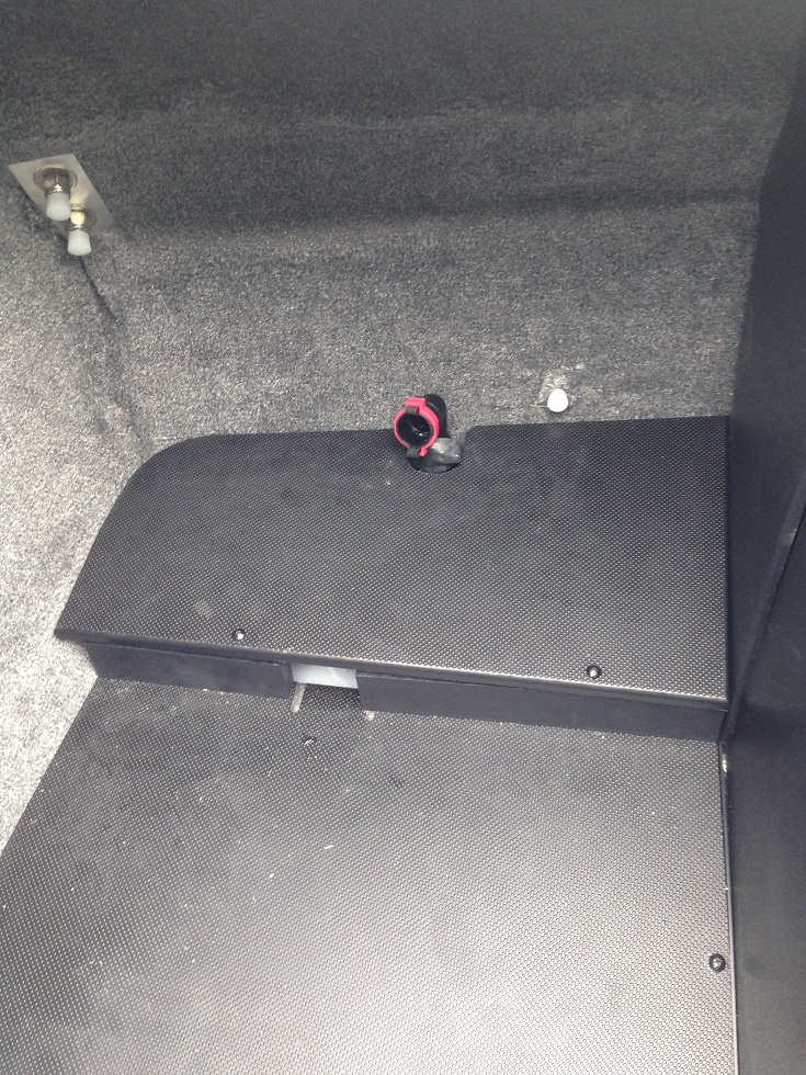

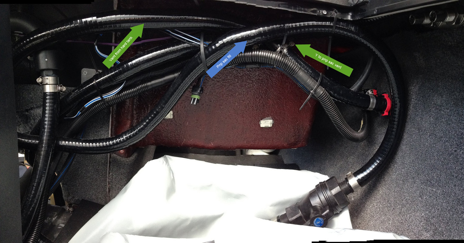

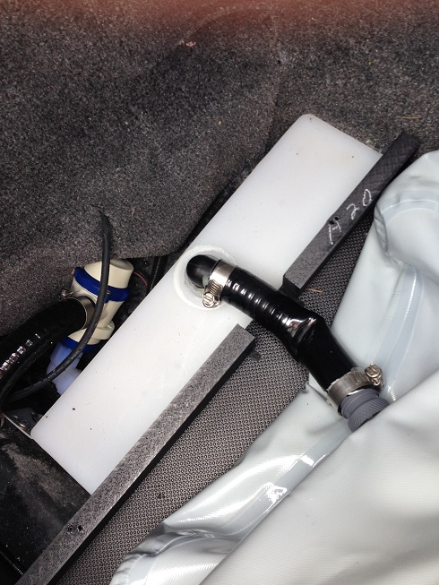

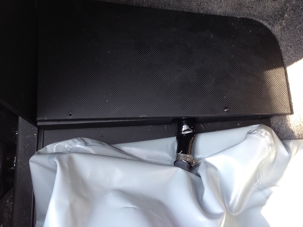

I have a new 2015 Axis A20 and had some issues with the ballast sac installation.
No vent line and rear drain line not far back enough and making a kink. (see pics)
I tested installation of check valves on these drain lines to the hard tank.
With the sac filling valve closed, it avoids the filling of the sac through the drain line, but the resitance of the check valve hinders the gravity sac draining. So I took them out and rerouted the rear draining line in order to have the sac connector as far back as possible. (see pics) and abondoned the idea of filling sepreately the hard tank and the sac.

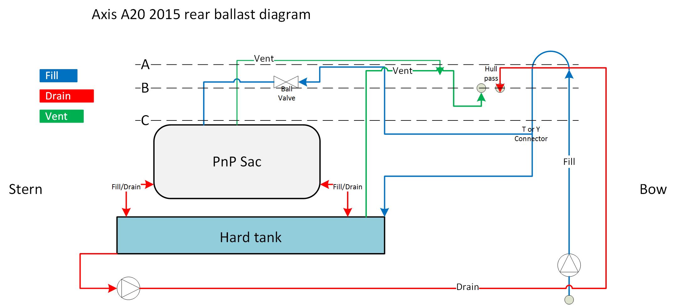

I installed a sac vent line and Y-ed it with the hard tank vent line. (See the diagram of the installation).
The hull outlets aren't at the highest possible location. So, in order to optimise sac filling it is important to route the vent lines (sac and tank) as high as possible before connecting to the hull passthrough.
Remember, bow is generaly higher than stern.

The other pics

And the line diagram
