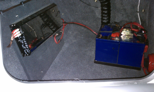

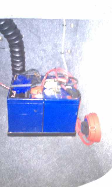

I forgot who asked for photos of my amps and battery set up, and I promised to send you pictures. Well I have them, so here they are.
One Syn6, 2 Kinetic 2000's and 1 perko switch with 1, both, 2, off.

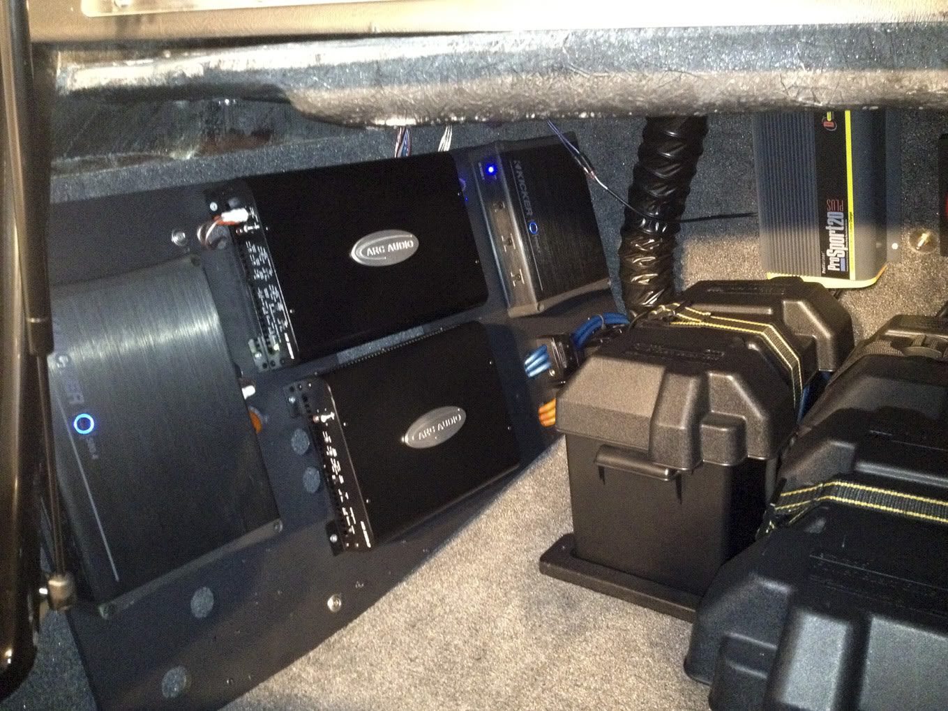

2 batteries on stereo/1 starter
4 amps with a Prosport charger

Good god AJ!!! Do you keep 300lb of lead under the driver seat to even out the boat!!

Lol, I keep a case of bottled water, extra beer, and Gatorade under the seat behind the driver seat and that seams to keep it level. Sometimes I might put a little water in the rear right ballast tank if needed.

why do u need 4 batteries?? why not just put larger ones in ?

I play my stereo at the sandbar for up to 6 hours at times plus I have a LEDs throughout the boat and 2 pretty powerful underwater LEDs that I keep on for 2-3 hours. My 3 stereo batteries are group 29's so going with just 2 group 31's would not have gotten me near the amp hours the 3 group 29's do. I originally just had 3 batteries but added the 4th when I added the lights. Had I known I was going to add all the lighting I would have just gone with 2 6-volt Trojan batteries.
