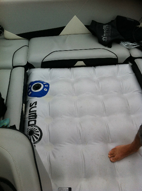

here is the Sumo 800 floor sack, the production model. As you can see, it appears to have been made for our A22's (and A24) as it fits perfectly. This weight really low and in the middle of the boat seems to add a little bit steeper lip to the wake. And it is easy to walk on as well.
