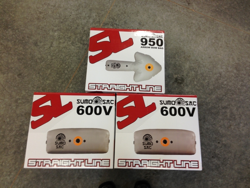

I ended up going with Johnny’s suggestion and getting all sumo sacs, and I'm glad I did.
I've never had any of the flyhighs bags so I can't compare the two but the Sumos fit in the rear compartments and under the bow perfectly, no real pressure point to worry about that I can see and with the 600s there is no need to re-enforce anything (which is something I didn't want to mess with). Also I really like the "Quick Link Valve" fixture on the Sumos, it's awesome for burping the bags and since the ports are all 1" I was able to up the size of the hose that gravity drains the rear sacs to hard tanks on my '12 from 3/4" to 1" very easily which really seems to help drain faster, I don't have to wait for the sac to catch up to the pump like I've heard some people complain about. Here's the thread on it viewtopic.php?f=14&t=1688&start=10
I have the AR335 engine and went with the Acme 1235 prop, it has zero trouble getting the boat up and going with the almost 3500lbs of sacs plus a few people, I'm super happy with its fuel economy, and didn't seem to lose too much top end either.
Thanks again to everyone for their advice much appreciated!

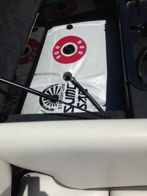

Has anyone tried the Sumo V900 sacs to see how they fit in the Axis lockers? If so, any pics?

Did you reinforce the side walls for the 900? Happy how the 900 fits? Lockers the same size on the A20 vs A22?

I'll be reinforcing the walls. I've used the 900s for a week and the force was sufficient to push the divider out of its track on one side.
