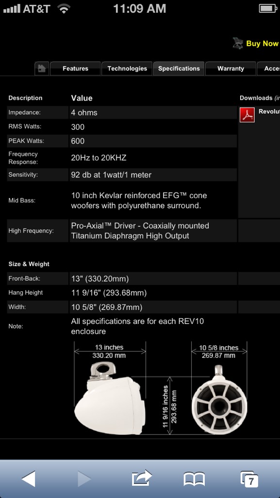

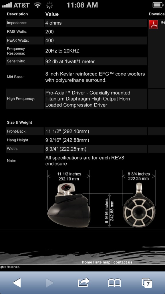

Either way you definitely won't be disappointed. Here's the hang height difference...
9, 9/16" vs 11, 9/16"

Thanks everyone, think I will go with the Rev10s afterall...not that much size difference, but I think the sound will be slightly better even with the HT4 amp. Pics to come!!!
