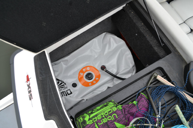

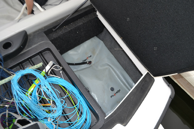

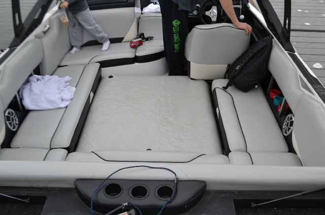

a few pictures of the sacs and setup
File comment: sumo 800 floor sac, ballast porn for you all
File comment: sumo 600 filling
File comment: fly high 750's filling up

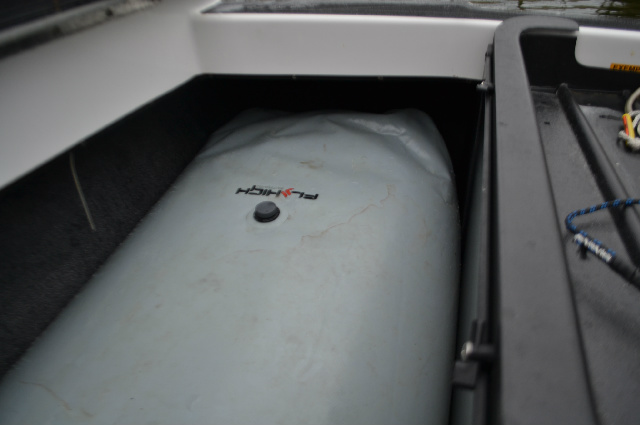

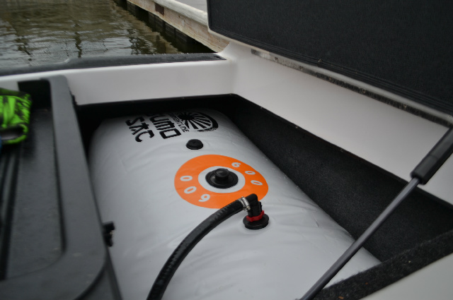

File comment: 600 full
File comment: 750 full
