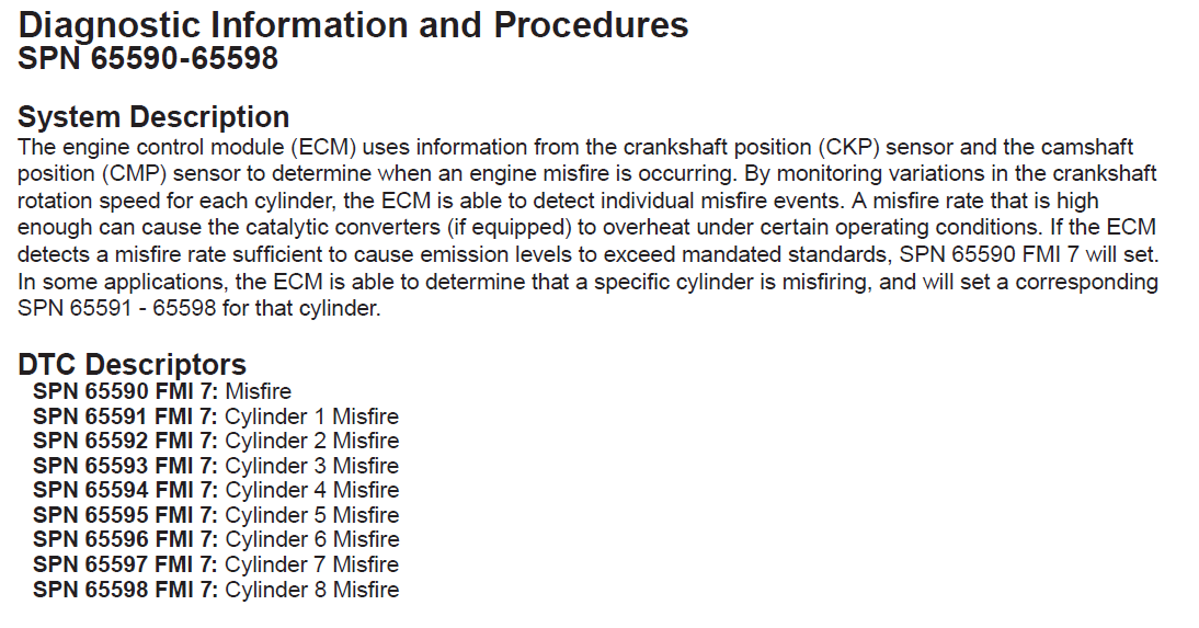

I hope this helps. I googled it.
Entire manual found here.
https://www.bakesonline.com/images/Medi ... manual.pdf

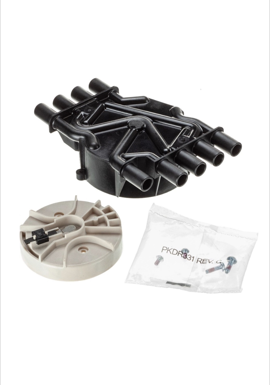

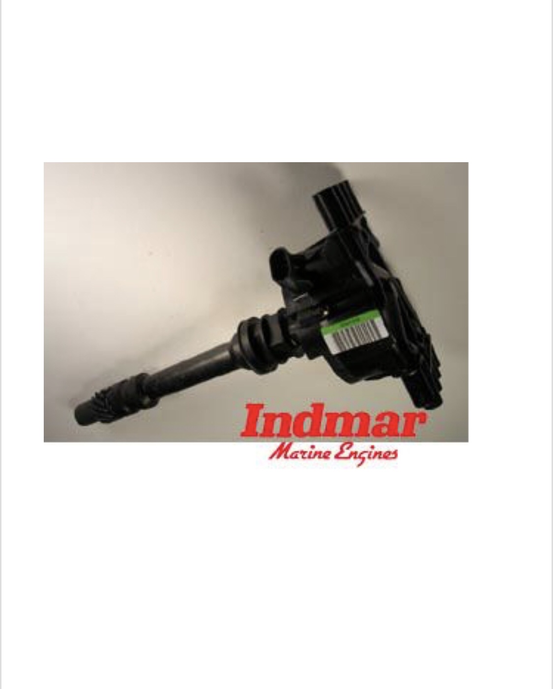

Did you replace just the cap and rotor or the entire distributor? I have the same problem and was trying to figure out which to purchase.
I just replaced cap and rotor.
