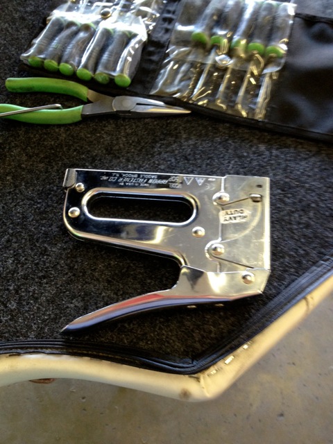

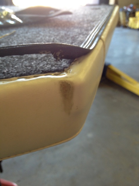

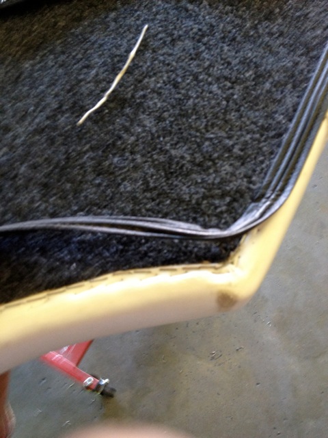

just did a minor repair on mine today, the dealer was nice enough to ship the skins to me to save me the trouble of dragging the boat to them and paying an upholstery guy to fix it, warranty does not cover labor after 1 year, so I took it upon myself to fix the rubbing problem and save the skins for when I really need them, now if the rub marks don't get any worse I will keep the original skins on until they start to look bad. woot!!!

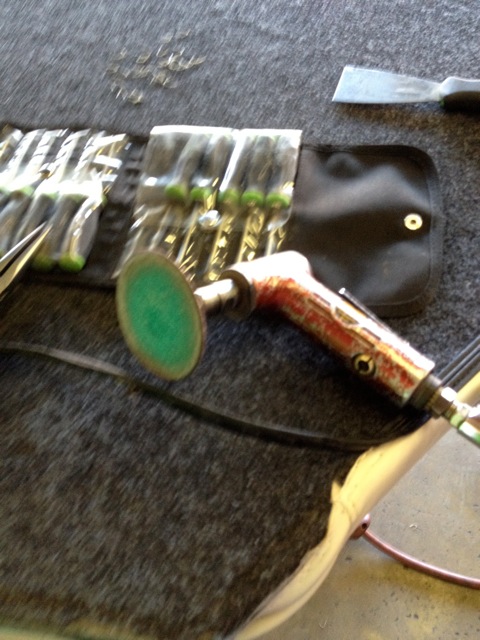

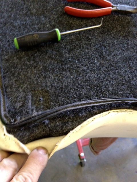

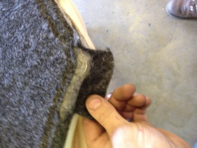

more, the doors are made out of a really high density foam so they sand really easy, getting to it is another story, Axis was not skimpy with the staples
