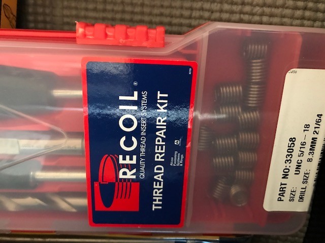

I had the exact same problem. Just get a thread repair kit and follow the instructions. I used a recoil thread repair kit and it worked like a champ.
That's the plan! Thanks

I ended up using zinc drywall anchors on the engine hatch. Can't see it and the larger diameter bites really well in the softer
/loose seat base material.

I have Exact same A20 very lightly appointed; I noticed that early on luckily when I noticed it wasn’t quite closing properly and now every 6 months I need to tighten screws , got lucky 1st time had only 1loose/stripped screw and got it to re bite on an angle.
I’m also more careful now and lift slowly till it gets to the last couple inches that the arm takes control. Just regightened them last week cause I noticed the one side closing funny
Wish I would have known about tightening all the screws I can see on the boat at least once a year like I do now
Love the zinc drywall anchors cause they will bite the hard back quickly and can re-use SS screws !!!

Posts: 38
Location: East Berlin Pa
Another fantastic design by Malibu/Axis. Like everything else cheaply designed on an expensive boat. My 2015 A20 the screws came loose. Took the seat back out and drilled a hole large enough for a socket to fit directly opposite the hole for the strut. Put a nut and locking washer on and tightened down. Not coming out now and if it would loosen up have access to it.
