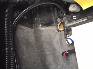

Here's what the rear looks like. The drain pump on the right. And the left hose goes to the rear of the PNP bag to fill and drain the bag.

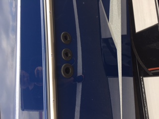

Here's the thru hull fittings. Looking from outside the boat the rear most port is the drain. The middle is a vent for the stock hard tank. And the furthest forward to the right is the bilge
File comment: Here's the thru hull fittings on the starboard side. This is taken while lying on my back looking up at it. The far right is the drain. Middle is the vent for the stock hard tank. And far left is the bilge.

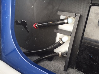

Now for the Vent install

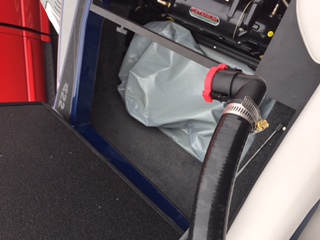

File comment: Remove the air vent on top of the bag

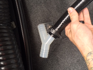

Posts: 24

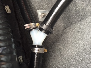

Measure out how much hose you will need and cut it with a pvc pipe cutter. Then attach a Wye. This one was bought from board stop. Use silicone and hose clamps. It's also a good idea to wrap all clamps with electrical tape so that they don't puncture the bag.

I'd also wrap the hose clamp with electrical tape to prevent accidental puncture or scrapes/cuts to your hands later on.

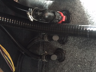

Cut into the drain and attach he Wye in the same way that you did before.

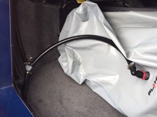

And that's it. Attach the Elbow to the straight fitting on top of the bag and you are done.
