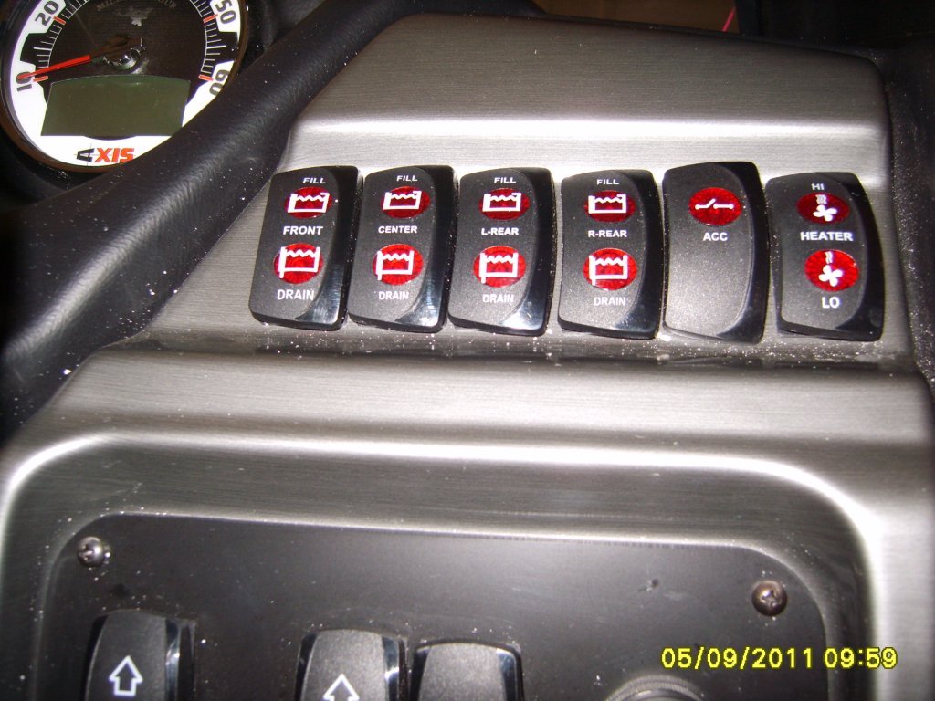

Well the weather finally warmed up enough to get out yesterday, though the wind was blowing like a bitch, anyway I have a few questions about the ballast system;
First of all there are four switches though there are only three tanks?
Is the center/middle tank considered the front and center both (two sections)?
Or is the front ballast switch for the PnP system?
The other thing was when we hit the fill switch you could see water pumping out the side of the boat like it was draining, what's up with that, does it pump in water like a siphon (which also pumps some out)?
How exactly can you tell if they are full and or empty?
Finally, there was water in the bottom of the boat when we got home that I had to drain, I'd guess about 5-10 gallons though it is hard to tell. When I reached my hand down to unscrew the drain plug it felt like about 3 inchces of water down there.
Thanks for any info you can share, this is the first ballast system so I feel a little stupid about it.
Heres a photo of the switches I'm talking about, and one of the boat for the hell of it, looks killer!

"Center" tank is the stock tank in the belly of the boat. "Front" is for the mushroom sack that goes in the bow.
The tanks were probably full and the water coming out the side was the overflow vent.
Check all the connections on your ballast tanks/bags if you have pnp to see if you have a leaking fitting. That seems like a lot of water. My boat rarely has any water in it.

Open your chillax seats and take a look, mine had a y connection hooking the fill, drain and overflow together for the front pnp so the boat doesn't take on water, that might explain why it was coming right out as soon as you turned it on, you need to remove the y when you install the front bag, and put on the quick connectors. Elc is right about the switches, center is the factory tank, front will be the bag, the '10 models didn't come with the front switch, it just says acc, and there isn't a light on the drain side so you have to be paying attention on that one
Thanks Walter, I was just under there looking for the darn lines for the front PnP bag and could not find them...now I see why. So it was the front pump just passing the water right through the fill to drain lines.
I'm glad to hear they Y'd theme together like that or it could spell dissaster if the switch was hit and left on.
Mine is a 2011, if I'm hearing you right the switch will light up on the drain side when the tank is empty?
