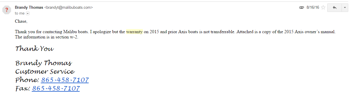

As far as warranty, see the attached email. Does not transfer.

So the Axis warranty from Malibu may not transfer, but the one from PCM regarding the Engine should. Malibu doesn't honor that, PCM does.
