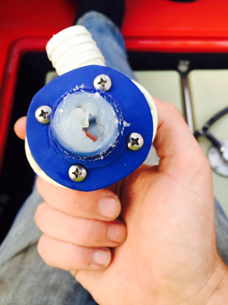

 Post subject: Re: Pump question?
PostPosted: Fri Aug 28, 2015 6:25 pm
Joined: Mon Jun 08, 2015 7:57 pm
Posts: 30
Finally pulled the drain pump and found this!!
PostPosted: Sun Aug 30, 2015 6:52 am
Bagdragger, take those 4 screws out and then look at the impeller. Do NOT clean out the silicone. That is there on purpose to seal the electrical connections inside the pump. You're not looking at the pump, your on top of it.
