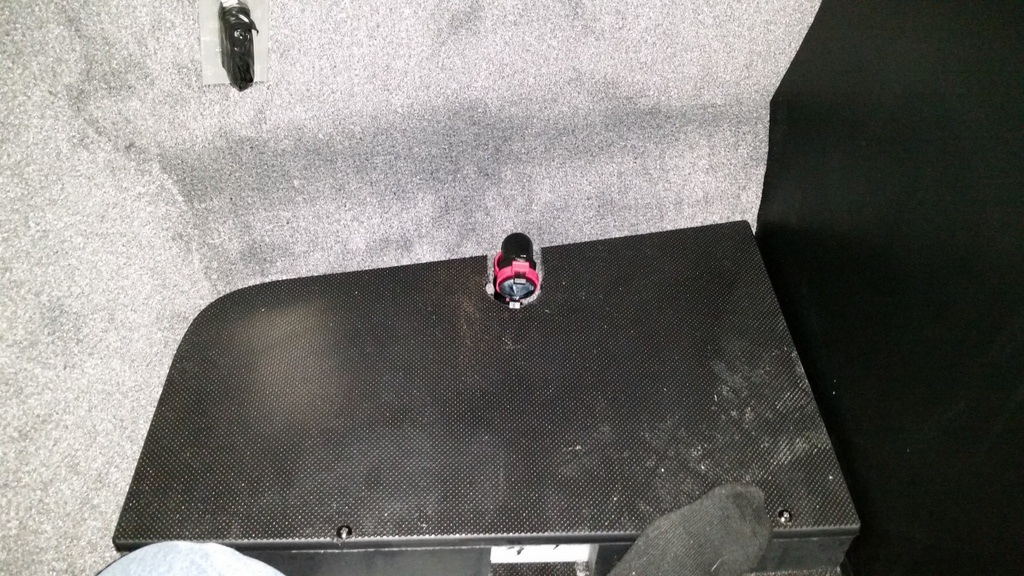

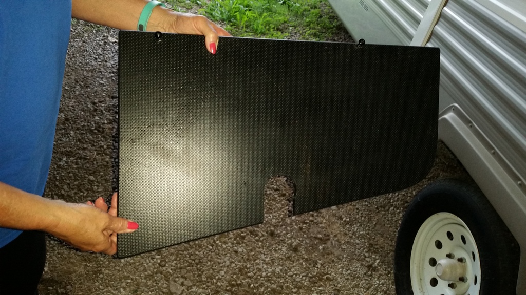

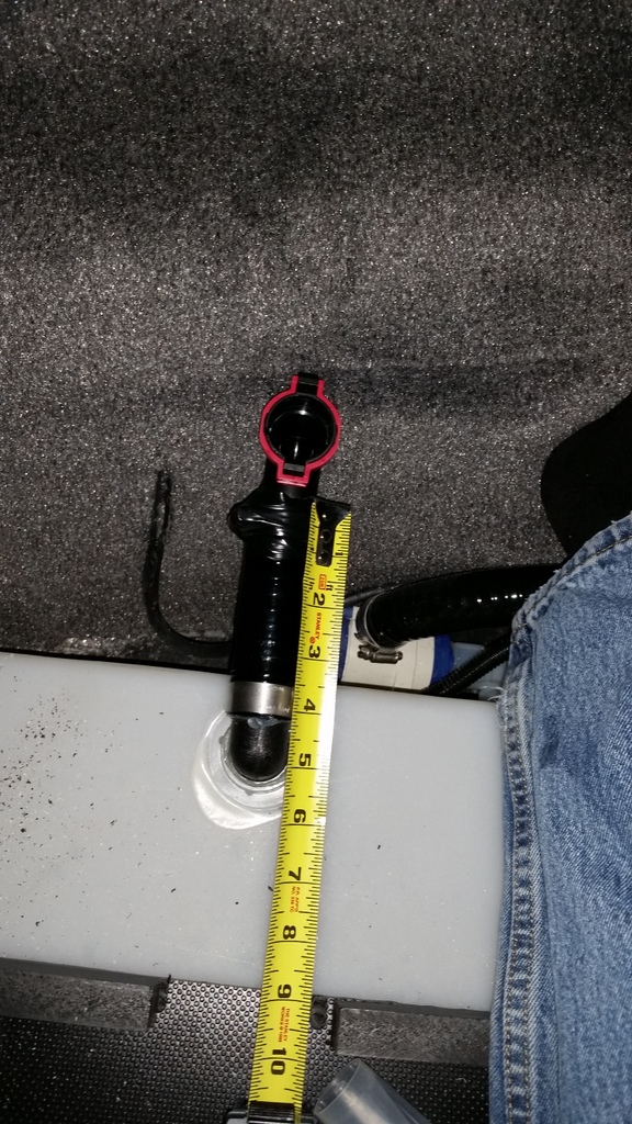

okay, I got it. did it the way AJWest did (thanks AJWest, great mod) except that I did not reinstall the straight fitting after I trimmed the hose. also, on the 2015 A22 the hole trimmed length is about 4-5" long. with it being so short, I eliminated the straight fitting and went to the 90 elbow. a also taped the transom bolts. see pics below. i wanted to add a few more pics but cant. never had to jump thru so many hoops to add pics to a forum thread.

PostPosted: Tue Jun 02, 2015 1:15 am
Glad my own mod is helping. Pretty simple. Thanks for the pics for the 2015 boats.
