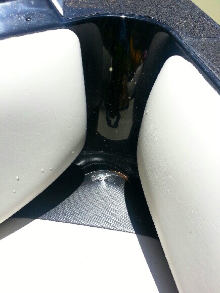

This is the spot in mine, was in each corner of bow, Malibu re did the seats under warranty, my choice I asked them to do them in white, and have since had the axis logo deck trak cover supplied my Malibu also under warranty.

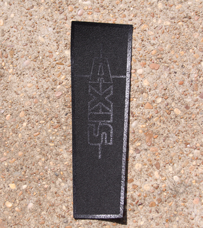

[quote="AJWest"]I guess the Malibu/Axis engineers didn't think the curved gel coat would act like a magnifying glass and burn/melt the vinyl. quote]
Exactly what is happening. The only fix they offered was a black Axis decal to put in the corner to break up the sun beam.
