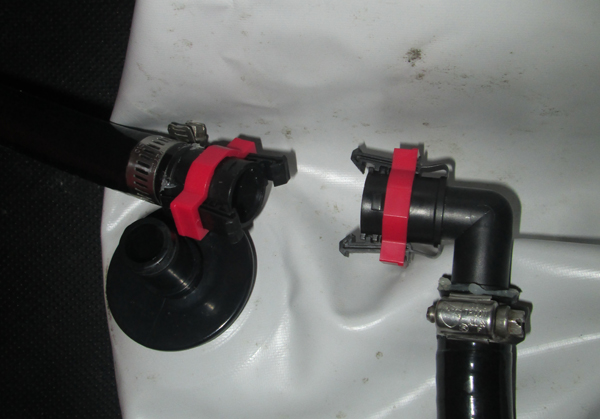

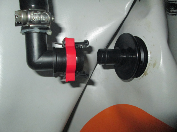

Alright, I want a quick way to bypass my rear ballast bags and just fill my hard tanks. I want to disconnect the fill line and drain line and connect them some way. Has anyone done this...? How would you go about making it work? Need some kind of quick connect to fit the two ends together.
Maybe buy two bag fittings and somehow find a way to connect them by the threaded ends...?
Thoughts....

If I could buy two of these and somehow find a piece to attach both of the threaded ends I would be in business. Just disconnect from bags and connect together with piece and done.
I would love to know if I could add the ball valves to my existing set-up and how difficult it would be. Of course for my purposes I think the quick connect fitting would be my best route for now.

Couple of these and a short length of hose should accomplish what you are looking for
http://www.wakemakers.com/flow-rite-3-4 ... tting.html

Here is an option for you( basically same as dman, minus the wakemakers price gouge). Go to --- https://www.flow-rite.com/marine/products?page=1 , buy (2) MA-032 (since you have 3/4" lines). Connect barbed ends with whatever length of hose works best. Install when needed. Done. :D
Wow. Already ordered. Wish I had this earlier. Good Find.
