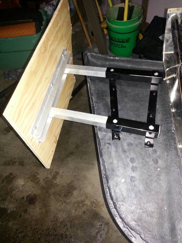

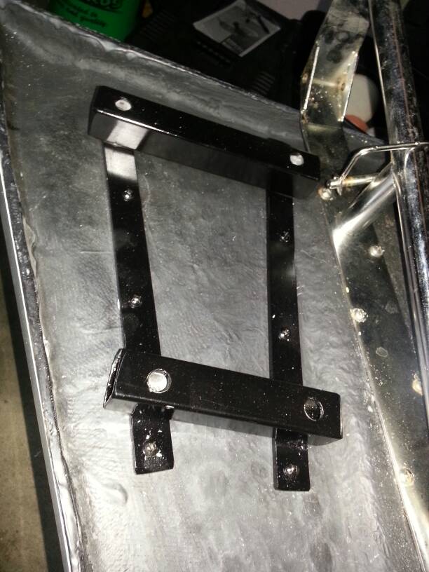

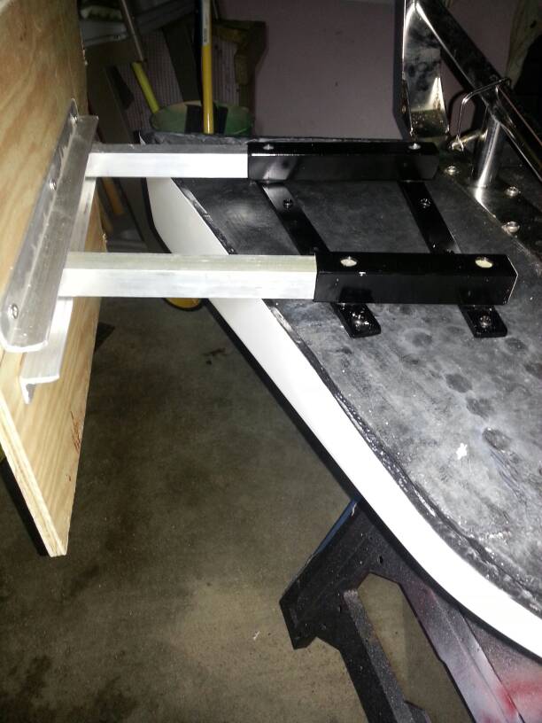

Here is the one I made for my weekend at the cabin. I started it at a pretty sharp angle because I just have to cut the back pole shorter to adjust the angle in.
For the first time we have been able to surf without the rope with just my wife and I in the boat. I had to soften the angle once already because steering sucked. I cut an inch off the back pole and it was better but I will probably end up making level with the outside of the hull so steering is better.

Interesting what's it look like on the boat
