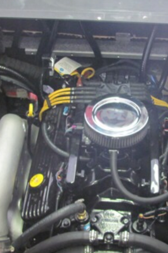

At the top of this picture where the paper tags are is where it will be attached
It's a hose screwed into the drain plug hole in the pan, I'm not sure if it will reach the bilge drain hole or not but it's worth a try.
