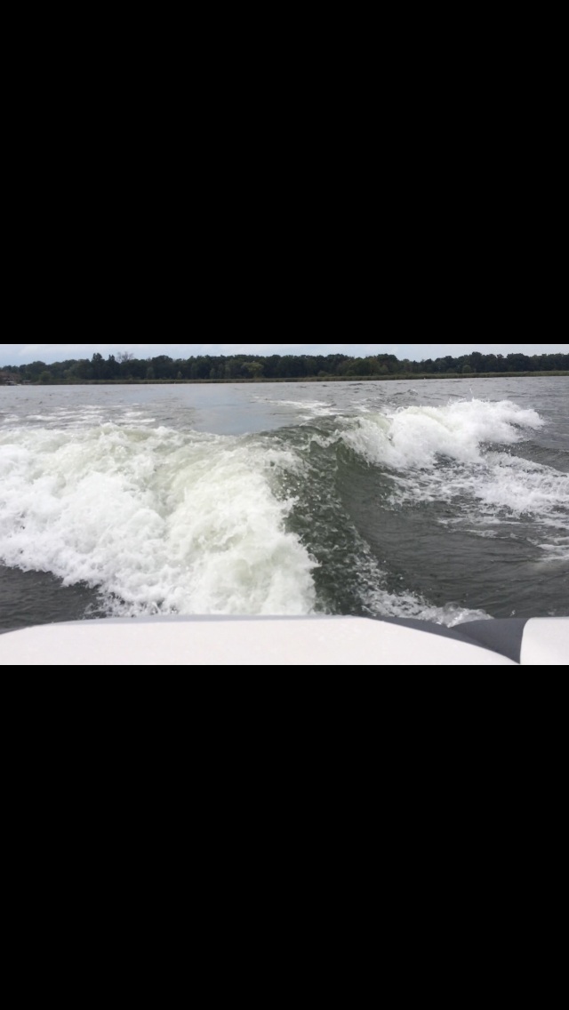

I have a 2013 axis a22 no surf gate. I have plug and play and for surfing I fill up the 750 in the left locker and the center hard tank, it's ride able but it could be better. Over the weekend I borrowed 2 200 pound fat sacs and put them on the surf side and it was a lot better. I'm going to order some but I'm not sure what to get and is there bags that don't bust water all over the place when I go to put the cap back on, like a valve or something built on to one? And when ever I put the wedge down it all turns to white water no curl or anything so I leave it up. Thanks
File comment: This is with 750 in the left locker center hard tank full and the 2 200lb fat sacs I borrowed.

What speed are you going at? This year I sped up to around 11 and found that it helped a fair bit. Prior to using a do-it-yourself surfgate I was loading with 900 in the rear, center and front full plus another 700 on the seat behind the driver (we all surf goofy).
I'm using a fly-high bag so I get a bit of spill when disconnecting the pump but not much. Sumo bags have a spring loaded valve for their pump - http://www.boardstop.com/product_info.p ... ts_id=1449. You can get a check-valve for Fly-High bags as well - http://www.boardstop.com/product_info.p ... ts_id=2442

Agree with 67King. The wicked wave kit is legit. If you don't go that route, try a 370# tube sac or 400# bag on top of the surf side seat. You also need bow weight so fill the arrow bag at least.
