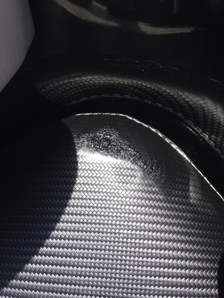

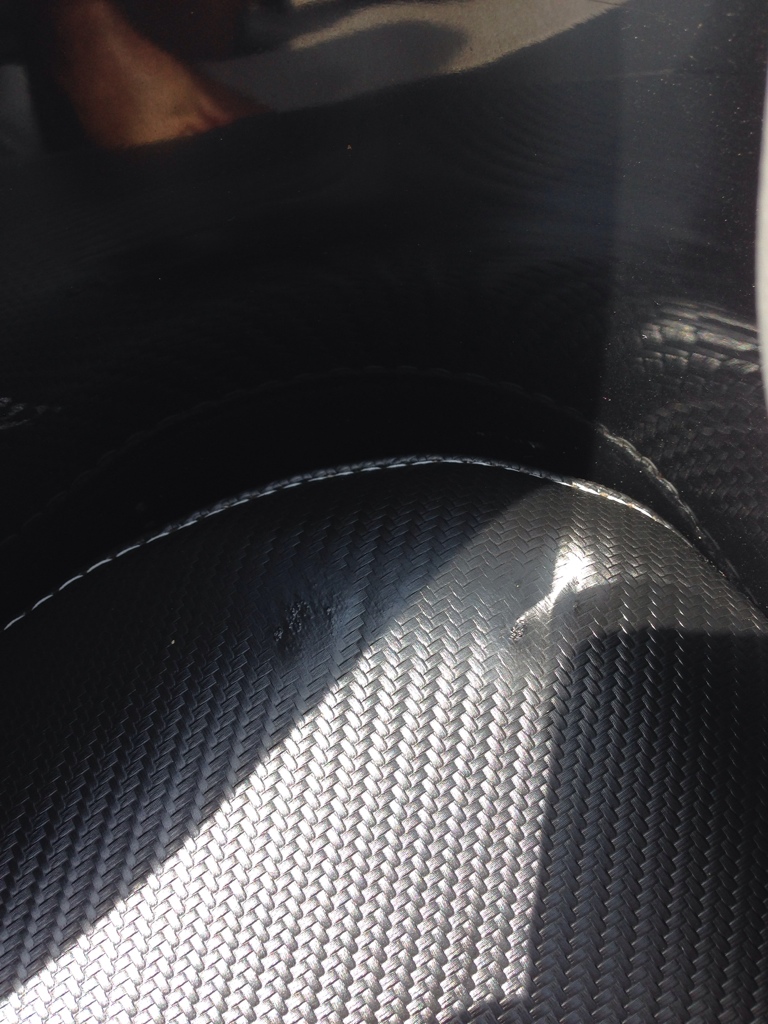

So have Black Boat with green flake paint, looks like parts of front cushions are melting.

Anyone else having am issue like this.

Yes its a known issue axis replaced my front skins for free. The 14's have a piece of deck trac on the gel coat in the corner above that area.

Thanks SDUKES. I just reported it to dealer today. Live boat but this stuff frustrating.

This should get you up to speed on the issue. Hope this helps.
viewtopic.php?f=14&t=2173

Thanks, Awesome information I should have researched on site more. I am close to being out of warranty, so hopefully it is covered.

Within 12 months and it is covered.
Outside of the 12 months and it should be covered if they haven't provided you with 'the fix' yet.

Mine just did the same thing. Sucks!

Well spoke with Dealer, they were awesome. They have put in the claim on the seats and are waiting to hear back from Axis. Great information given by the rest of you, thanks very much. Its great to share the info and help others. It is very much appreciated.

Since your boat is black I would get some Seadek and stick them in those corners so the sun will not reflect or you can order some traction pads from Agenda Surf cheaper.
