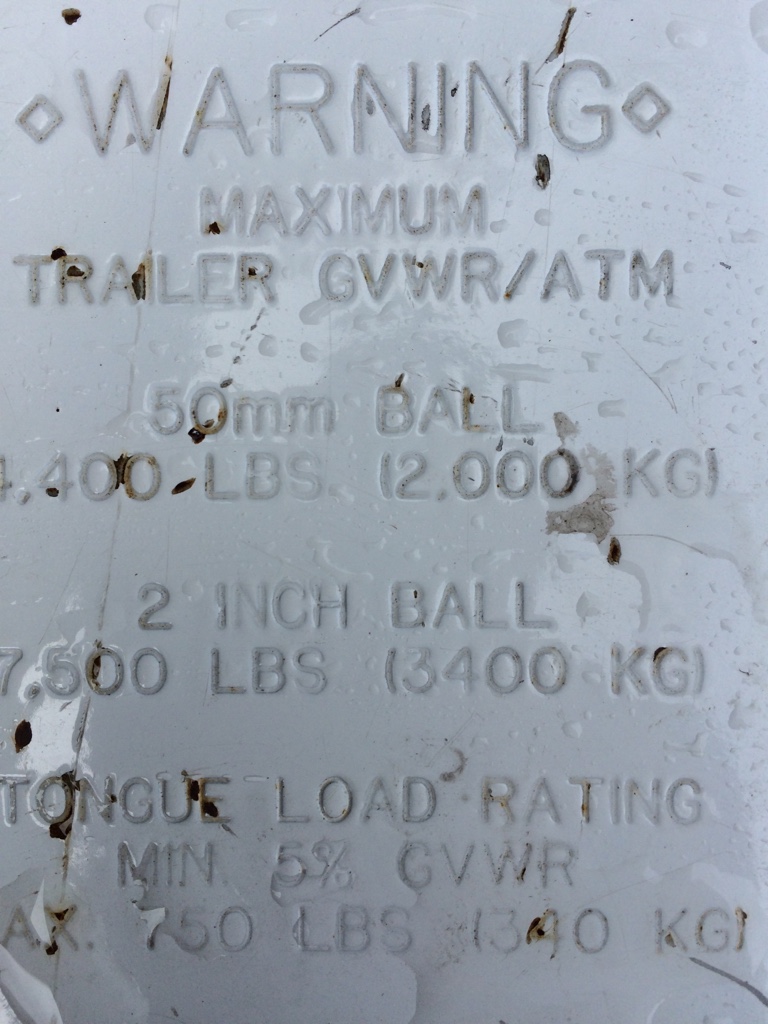

2" on my 2012 A22 boat mate trailer

Ok, cool thanks man. My trailer tongue said the same, didn't know if anyone tried anything different. I just have to avoid the potholes more then.
