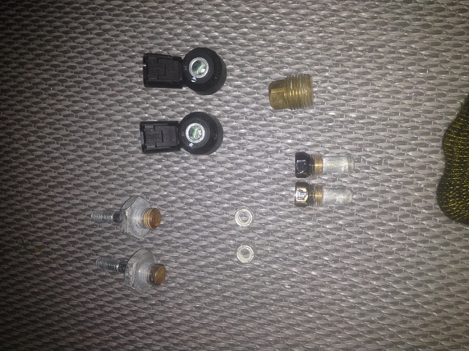

I have a new to me 2013 A22 with the 350 Monsoon. It was delivered to me winterized so I do not know where the plugs go. The attached picture shows what needs to be put back. It looks like 2 knock sensors on the left side. The 2 anodes on the right are for the Vdrive?? Is that correct? The Indmar manual says to put pipe sealant on the knock sensors and vdrive anodes? Is there only 2 drain locations on the motor? Thanks for any insight.

the big brass one goes in the rear at the bottom of the rear transom .... I hope those are just spare knock sensors because if they are in the truck location they are under the intake and that's a job. unless they go on the long studs and those could go in the side of the block. as far as anodes if you remove the rear seat and then the cover it should be right there between the transom and gas tank ...... if you look at the winterizing you boat thread it shows you all the locations but its for the 335 tho

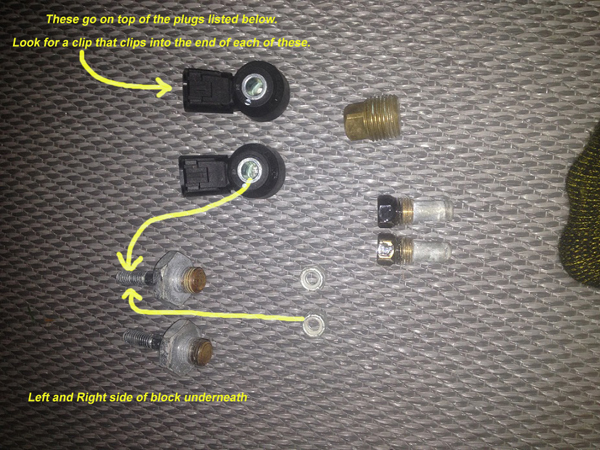

I will try to get some pics this afternoon if you need them.

You do not need pipe sealant on the knock sensor plugs.
Check your J-tubes and make certain you use a fake a lake and run your boat before heading out to ensure you have no leaks... idle speed only.
