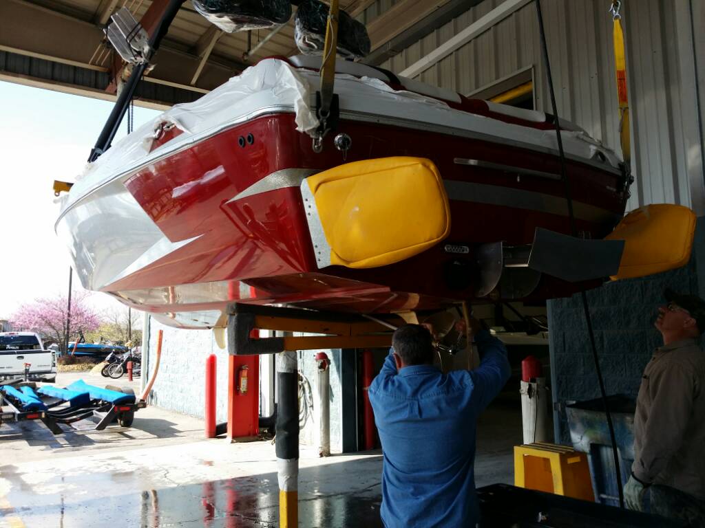

This was mine at the factory.
[attachment=-1]uploadfromtaptalk1400875985599.jpg[/attachment]
2014 Axis T22

Well I'll be.......that would account for the direction of movement of the d-rings shown in my photos. If that's common practice at the factory then something else contributed to the gelcoat damage since not every boat is damaged. Oversized holes, insufficient torque on the d-ring nuts or a combination of the two. Disappointing anyways. Sent off an email to the dealer I purchased the boat from but not word back yet.

Yes. Every boat is lifted that way. They water test every boat and that was mine getting the prop put on. I was actually allowed to walk under it and I was asking questions about the different ports on the bottom. Other than the stitching on the upholstery that everyone seems to have problems with...no. There were supposedly a couple of spots on the gelcoat that my dealer had the factory fix before I took delivery. I guess that's a benefit of living close to the factory.
