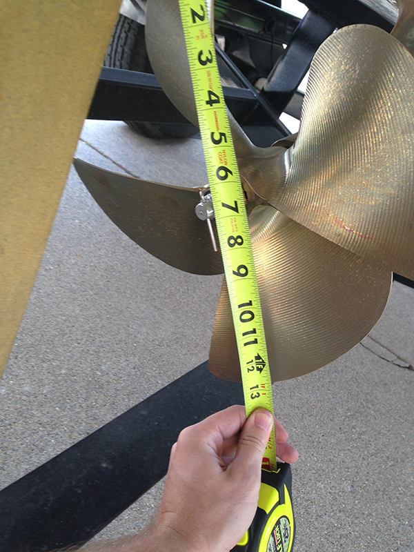

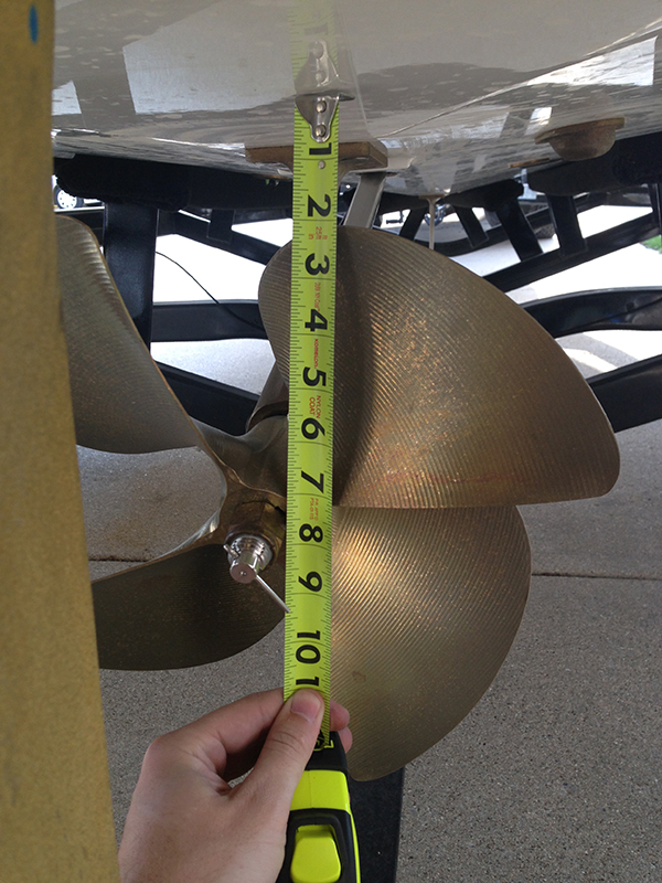

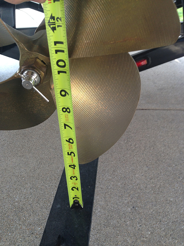

I'm running 2315 on my A20. No clearance issues at all.
