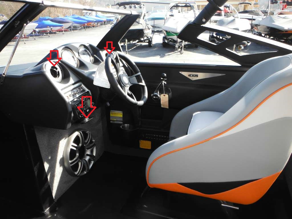

Does anyone have a T22 with the factory installed heater? If so, can you please tell me where the heater base unit is installed and where does the factory place the 3rd outlet? Pics would be great if possible.
I bought a 4-outlet system on the group buy at TMC and am starting to figure out the installation....

The heater base is installed under the driver's helm. It is mounted to the top of the wall that the bow backrest cushion is attached to. The factory unit that came in my A22 was a three heater outlet. You have your pullout hoses next to the guages and then one at your feet. The attached picture shows you the heater locations. I pulled the picture from T22 at onlocal dealer's website.

I would like to get heat to the passengers instead of all by the driver. I havent taken delivery yet so I am not that familiar with the boat. More to come....

Sorry I don't have pics of the heater in a T22 but I would assume it is mounted under the helm like all the A series from the factory. We didn't like the idea of the pullouts in the dash and our dealer did a custom install under the chillax seating. I know you have the walk thru but may give you an idea or two.

Cool, thanks. I am thinking about maybe doing something like that. Not sure yet... the pullouts do seem to pull out pretty far, so the one in the dash on the left could probably reach the observers seat pretty easily. I was thinking about putting one of the fixed ones aiming at the windshield as a defogger. Has anyone done that?

don't be limited by factory location you can put them anywhere as long as you have the space and the tube to reach

I have a T22 with the heater. Both vents in the dash pop out and have a really long hose. It's perfect for whoever is in the passenger seat or behind the driver. If you are getting warm you will be up by the windshield anyways.
