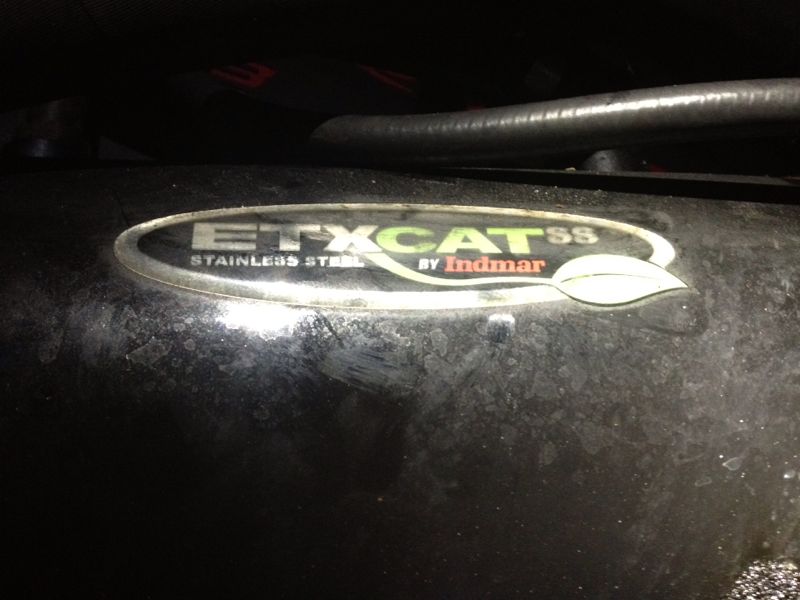

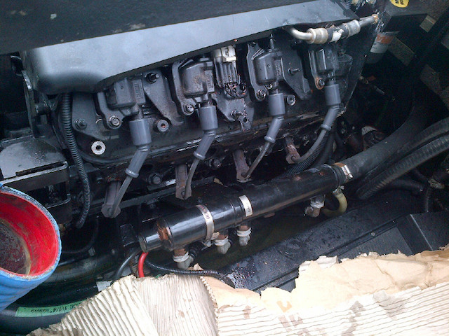

Hi All - I would really appreciate some guidance as I'm based in Abu Dhabi which has no reputable Axis/Indmar dealers.
My starboard MTX CAT SS on an Indmar LS3 6.2L sprung a leak around the nipple which houses the O2 sensor - the result was salt water all over the alternator which also needs replacing. We cannot manage to weld or silver solder the CAT so have decided to remove the starboard and port cat system and replace with standard manifold as the catalytic converter is not required under Abu Dhabi's emission standards.
So, please would you advise which manifolds to buy and where to buy them + the associated gaskets. Also, the boat Axis A22 2011 has a salt water system in place - i.e. closed cooling system which connects to the CAT with two pipes - where would I fit this on the new manifold? And finally, if I remove the CAT system what do I do with the O2 sensors?
Would really appreciate help and advice please.
Pics attached

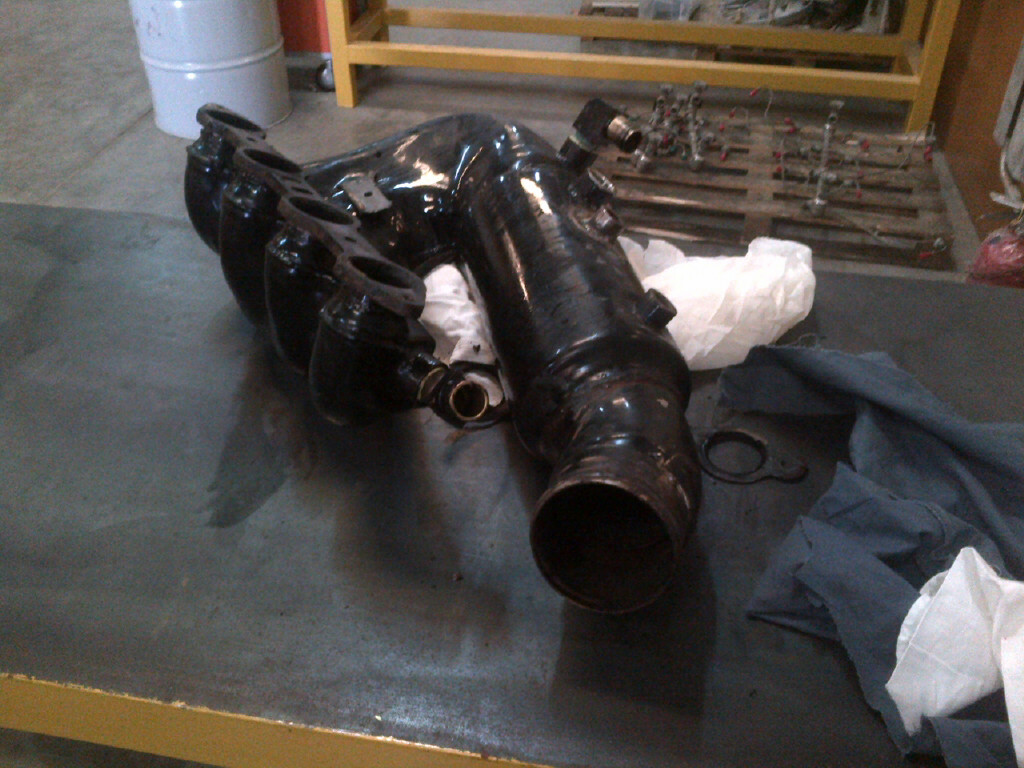

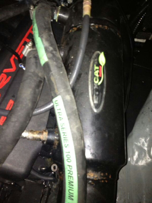

Sorry it is the ETX CAT - more pics attached
