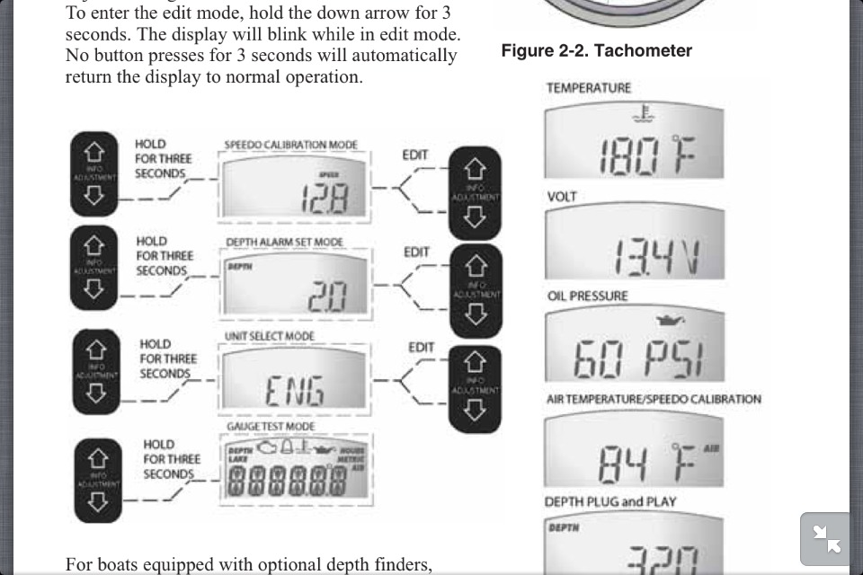

The process should be somewhere in here, around page 23, hold down the info adj button for 3 seconds while in depth mode to adjust alarm
http://www.m2omarine.com/resources/Axis_2011manual.pdf
