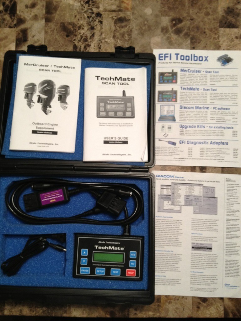

I bought one from Rinda technologies that works on all kinds of boats, 500$

Thanks Walter! Any way to stop the beeping/alert from continuing until the next time I turn the engine on?

Not that I know of, did the shift linkage get loose?

I have a buddy that has a reader he can hookup to his laptop. It looks like the electronic throttle control had an issue with only 1 single occurrence. We have not been able to reproduce, but it happened on a very wet rainy day when there was quite a bit of water in the boat. I'm not sure what could have happened, but we cleared the code and it is running great as it has been. I guess I'll have the dealership take a look at it next time it's in for service.
