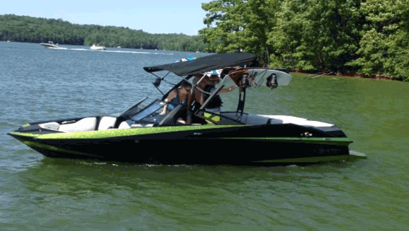

Pretty much what I was thinking but its nice to get confirmation. I think if I do anything I will stay far enough off keep boat deep enough it does not touch. Box anchor front, and spike back John good write up. I have been eying those box anchors ever since I saw one other day.
We dont do it much, but there are times when we catch bite to eat, meet up with others it would be nice. Beaching was wrong term I guess but best way I could describe. If swim platform is off to rear it would be easy for passengers to get off and on.
Thanks everyone. I love my boat, love the colors but Black is going to be a pain to keep nice.
