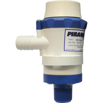

I noticed that my front ballast switch is no longer lighting up. This happened before when my rear pump failed. I am going to test the switch, but I likely have to swap the pump. Where is the front ballast bag pump located? I am using the PNP bags.

pump is located in the same location as your front drain plug( brass t-handle)
pump is:
Shurflo Piranha 800 GPH Aerator Ballast Pump

yup. screw open that 8" round access cover next to your driver seat. you will see your center and front pnp fill pumps next to your front drain T handle plug.
