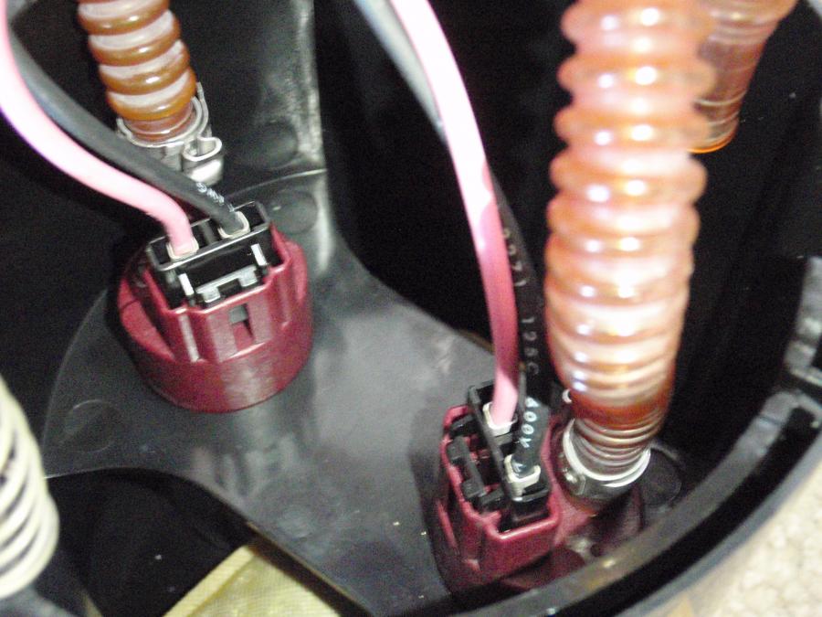

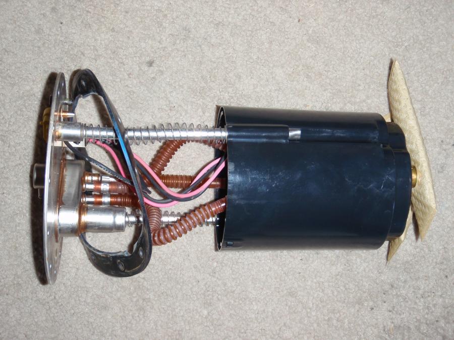

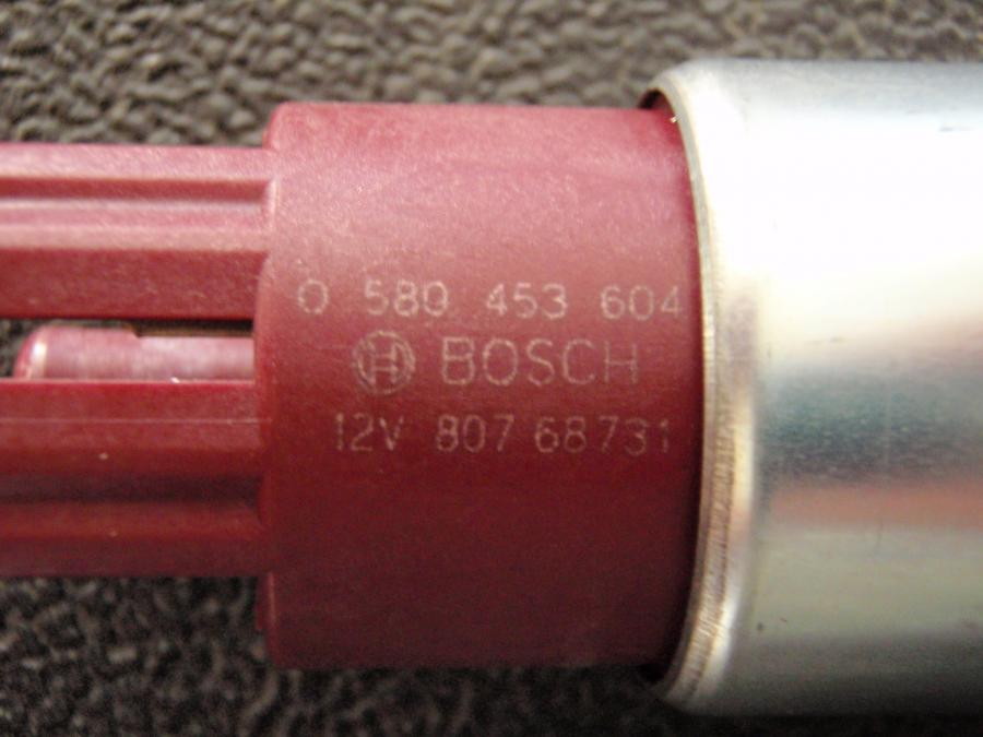

I had found a post on the mastercraft forum that showed the pumps from a 23LSV and they were Bosch. They took one to Napa to try to cross-reference and the number was found to be proprietary so they couldn't buy a replacement from them. I searched the number on Google and found some cross references for a few different pump numbers (E2471, YL5Z9H307FD, YC2Z9H307BA, KL1213350H). Here are the pics from the fuel pumps on the 23LSV.

That looks like the twin pump setup that's run in the ford GT, I've done a few conversions on mustangs and those have the ford connector.........and look very similar..........

the E2471# is an air tech number which is the common brand carried by any/all aftermarket parts places the next two # (YL5Z9H307FD, YC2Z9H307BA) are ford part numbers, the last on im not so sure about it kinda looks like a dodge # but doesn't come up so it could be just a generic #
