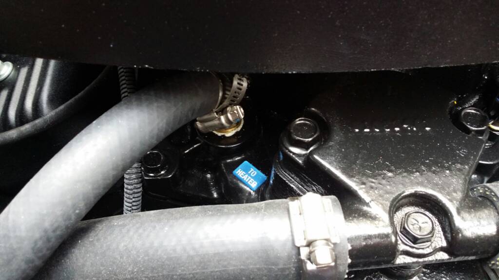

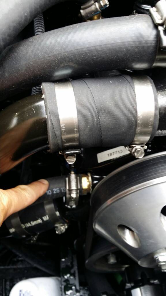

These are the 2 hoses I think are for the heater. I cracked the lower which I think is the return and got coolant out. I think I'm good to go. What do you guys say?

Walter...what do you think about the hoses in the pic's? Heater?

Ya those two hoses go to the heater core up under the dash
