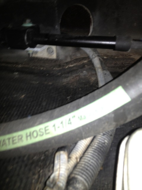

Ordered mine yesterday. I was reading through the installation manual online yesterday. I hope the one they send is better then what they have online. It doesn't even talk about where to install the low idle Y. I did look at my engine yesterday and it has a sticker (to heater) on the plug that we use.
When y'all are installing take plenty of pictures so we can walk each other through it.
Also might make sure on the low idle Y they send the one that is 1 1/4 to 5/8 and not the 1 to 5/8. The hoses on our boats are 1 1/4. Good luck everyone.

Ordered mine yesterday. I didn't mention the 1&1/4 Y tho. Did that have to be specified in the order?

I just spoke w Danny and he said the 1&1/4" Y is standard w the heaters. Don't need to specify. I also asked about shipping times. I ordered mine yesterday and he said it should ship by Friday but no later than mid next wk. So they're not going out super fast but at 40% off I don't mind waiting at all.

Joey. Did Danny give any advise on where and how to install the Y. Also I looked again at the motor and mine has both plugs labeled. One said to heater and one said from heater. Looks simple but this darn low idle Y is throwing me for a loop.
